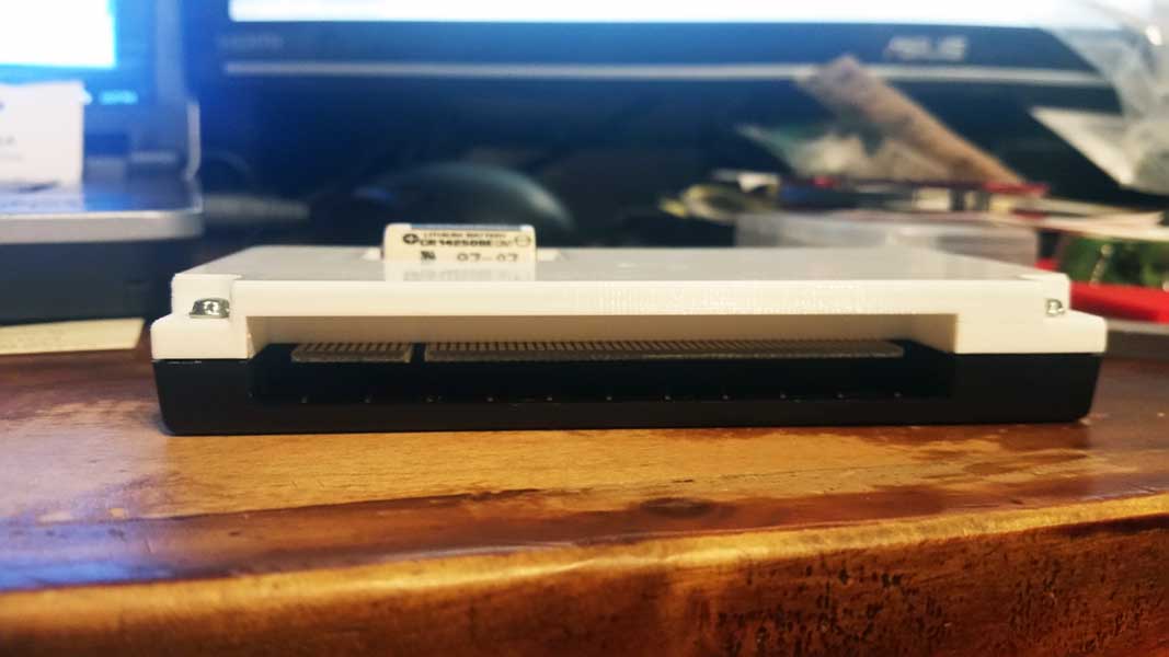

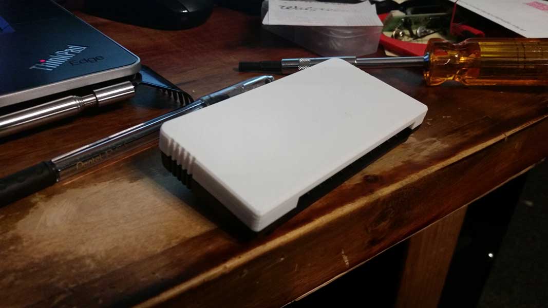

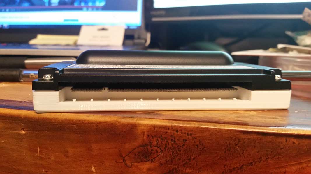

I got my CPS3 set in over the weekend thanks to Derick2k. I'm nearly half way complete the cart case. I've got to make some adjustments to the front and then I can start working on the back.

I've got the front all dialed in, will start working on the back tomorrow...

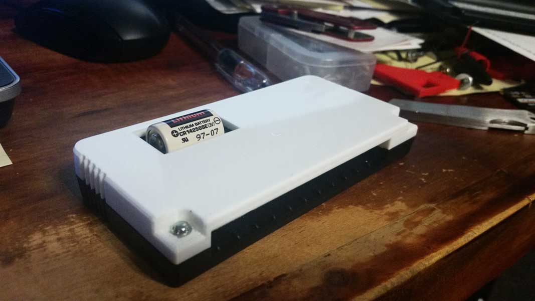

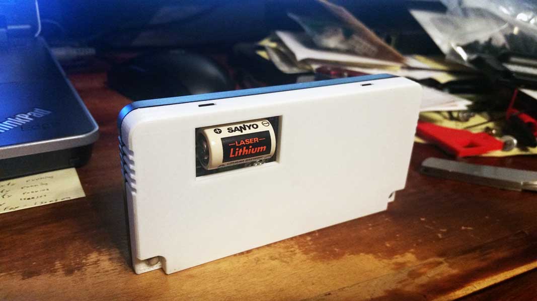

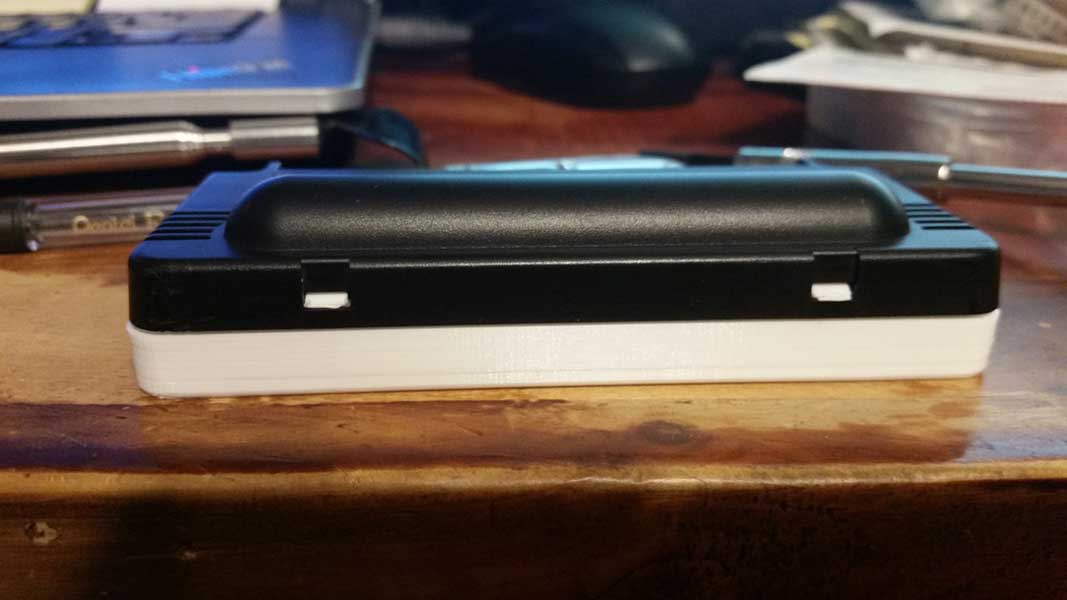

Back panel complete, just needs a few minor adjustments. hopefully tonight's test print goes well and I can release the files as I'll be gone for the weekend and you'll all have to wait until next week :P

Sweet!!!! :thumbsup: I kinda like the open battery space. Maybe have the bump out just around the battery? or a slide cover, like the type you see on battery compartments on remotes?

I'm not sure how I'm going to do the battery bump yet, or if I'm even going to bother since these are for the repo carts that don't have a battery and thus don't need the bump... I needed to add the cut out for the test print since I only have the original cart with battery to test with (though my first back cover test print I put the battery cut out on the wrong side lol). if I did make a battery bump version it will definitely need to be a separate piece though.
Hows fitment on the 2 sides you printed?
Great so far, though the latest round of adjustments may or may not change that so we'll see. the cart has a lip and groove all around the parameter to make the two halves lock into each other and there's a jog around the little grips on the sides that's proven to be a real bitch to get right, especially when trying to accommodate the slight ringing/over-extrusion that most 3D printers have in the corners.

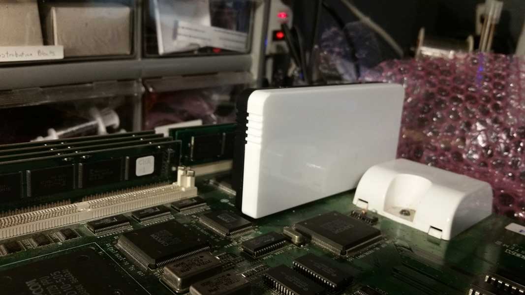

I got the 3D models tweaked and everything aligned to my liking. the two halves fit together perfectly and fit perfectly with the original cart housing halves. with the screws snug it has roughly the same insertion force and grip on cart slot on the mobo (at least it feels that way to my hands) and it fits perfectly within the original metal cart clamps. I've adjusted the battery window to accommodate longer batteries that stretch out to the further pin. I've also got the jig variants made and I'm printing a set right now just to make sure it provides all the space where you need it.
I did have to make one more last minute change I tried using a slightly oversized screw and snapped off one of the screw mounts, so I updated the model again to relax the screw hole slightly and reinforce the mounts. so once the jig test is done I'll do another final test print of the normal housing and as long as that comes out good (I so no reason it shouldn't) I'll release the the cart housing models (probably tomorrow morning):
