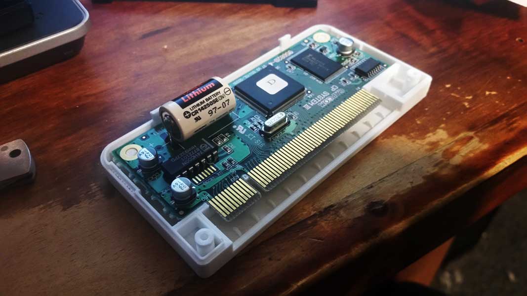

I got my CPS3 set in over the weekend thanks to Derick2k. I'm nearly half way complete the cart case. I've got to make some adjustments to the front and then I can start working on the back.
I only have the one pic right now, I let the print run over night and only had a few minutes to test fit the PCB and snap a pic before running out the door for work. I'll have more to show later this week :)
The case design is different from the original but I'm trying to make the mating surface as close to the original as possible so that you can use the 3D printed front with an original back or a 3D printed back with an original front.
