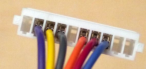

E: The reason for two different tools. Most contacts in the arcade world use an "F" crimp for the insulation, while Dupont uses an "O" crimp.
F:
O:
