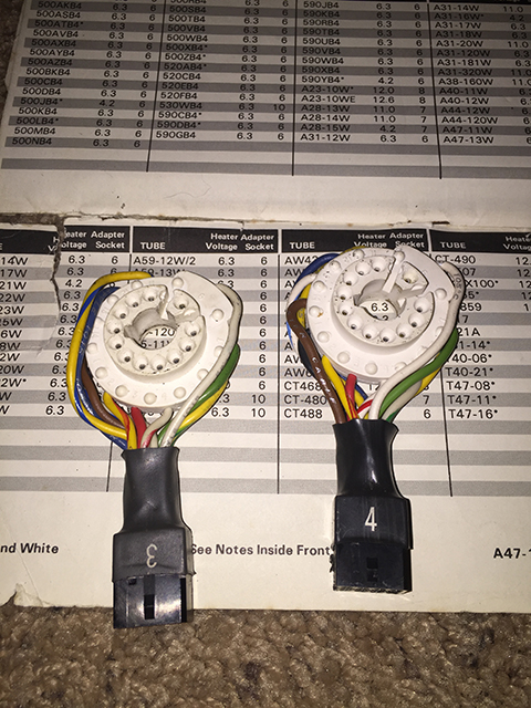

Ok so the BK467 came in today but I am confused on the adapters, I looked up my monitors serial and it turns out that I need the 23 adapter but can't seem to find one online or eBay. I do see some pics online of it or maybe I'm wrong but some pics have the #3 on the adapter. Now is this the right one? Ive tried plugging it in but it doesn't seem to fit. Can someone lead me to where I can find one?
Tube# A68KJU96X
Update:
So I bought the universal adapter but it was tricky connecting it to the tube one of the connecters didn't really seem to make contact with one of the pins on the gun. But I found a guy on Klov who makes the adapters and got one from him. This adapter just slid in perfectly.
When I first used the Universal adapter I got a low reading on all 3 colors, I researched online and looked at a few videos on how to correctly test and rejuvenate the tube. I first started off with a clean and balance which is the lowest and safest way to clean your tube. Nothing really changed so I switched it to the rejuvenate option, after I did that It gave me no reading at all in the test mode. I left it alone for a few days and got the new adapter from Klov which correctly fit on the neck.
I wouldn't recommend getting the Universal adapter, first its $80 bucks and second it doesn't slide in, rather its small hooks that hook onto each pin, maybe I must have had it hooked on a wrong pin, not sure. I used a diagram that I found online to see what connected where but maybe I did it wrong.
