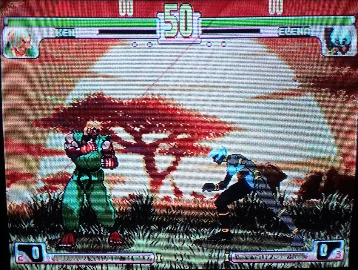

ISO with 3 versions of 3s preloaded just use the "MARUPA" method above to flash what color variation you want to use. 2 custom mixes named "PS2_DC" (console EX colors) "WILDBE" (wildberry mix). And the original colors "ORIGIN".
https://drive.google.com/file/d/1hG8-ZqFMg0MFXoXqkX6fjz1tDAbSrFgl/view?usp=drivesdk <-- burn to cdrom or sd card 😉 enjoy !!

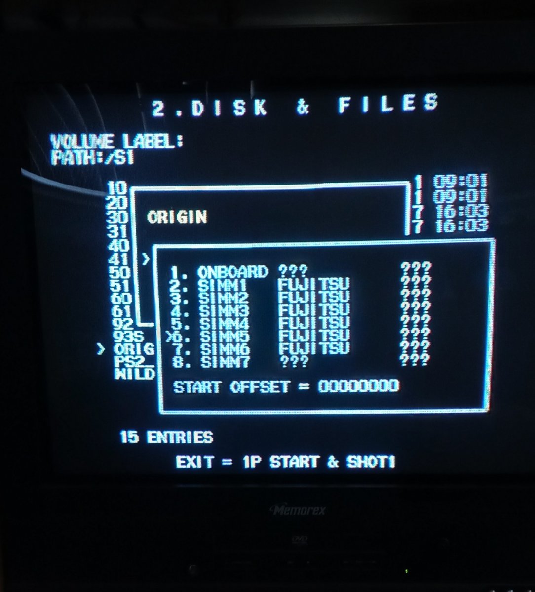

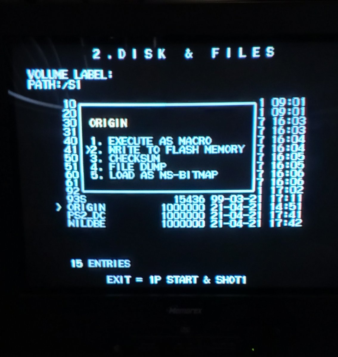

First download the image and you'll burn it to your sd card or cdrom. I use Win32diskimager, open it or whatever program you used and locate the "3sCPS3MIX.ISO" file and write to the disk.
Next insert sd card or disc in and startup your cps3. Hold 1P button until Darksoft menu appears. Then go to "Disk & Files" press shot1. Go to "S1 <DIR>" press shot1. The different mixes are located here. "ORIGIN" (original), "PS2_DC" (console EX), "WILDBE" (wildberry).
Go to which version you would and press shot1. Go to "Write to Flash Memory" press shot1. Go to "Simm5" press shot1. Leave start offset as is and press shot1 again. Let the program do it's magic, the actual write to flash process takes about 5 mins so go take a break and come back. Once it's finished, just reboot your cps3 and it'll will run whatever mix you wrote. If you have any questions, let me know.

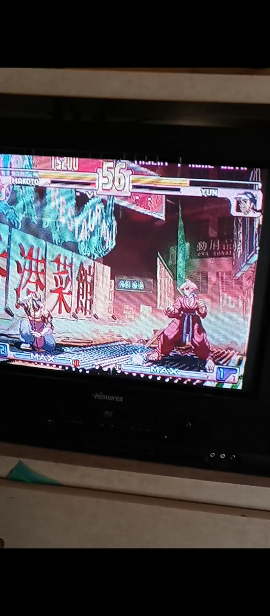

Original is the stock colors. Console EX is the extra character color pallettes that were exclusive to only PS2, DC, and Online Edition with no changes to special moves, Ex flashes, or SuperArt flashes but has some other minor changes to the VS select screen and the HUD. Wildberry is pretty self explainitory. It's wild and very flamboyant.
