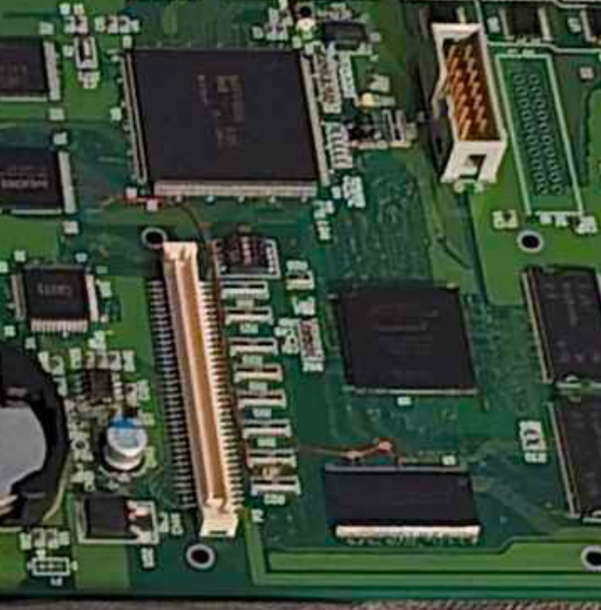

Yeah, I sold all my D boards but in my old pics my Akai Katana had a IS42S32400D-6TLIS42S32400D
