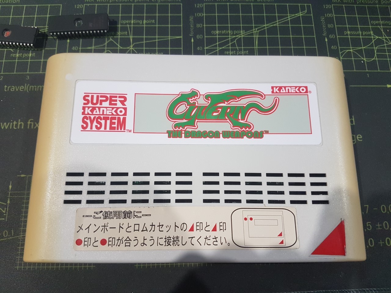

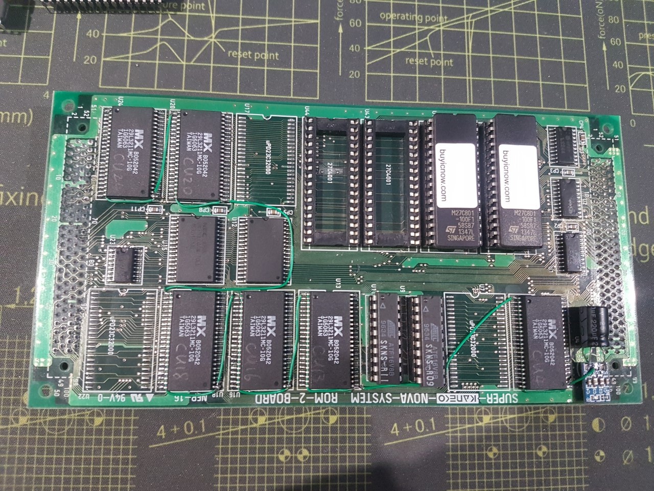

I can confirm your guesses about Cyvern. I managed to make a conversion using a ROM-3-BOARD, following your mapping table.I went through my carts and I do indeed have all 4 ROM board variants in my collection.
this is the mapping between the 4 cart variants as best as I can figure
* = educated guess based on position on the ROM board and MAME info.
N/A = not available
Thanks for confirming!I can confirm your guesses about Cyvern. I managed to make a conversion using a ROM-3-BOARD, following your mapping table.
.Same thing happened with me on two occasions. Not super bummed as I personally think the game is trash but I was converting it for someone else.Just got a few carts to make a Cyvern and Sengeki Striker, the Puzz Loop I received is a Rom 2 board.
Am I out of luck making a Sengeki out a Rom 2 board, it needs 4 sprite roms and there is only 3 on a Rom 2 board.
Anyway I made these in preparation.
yeah, so Sengeki need any board type other than ROM2, but I believe you can use ROM2 for CyvernJust got a few carts to make a Cyvern and Sengeki Striker, the Puzz Loop I received is a Rom 2 board.
MX29L3211 are EEPROMs that could be burned many times by setting pin 1 to "low". We need to put it to "high" by ourselves in order to set them to "read only mode".Im just starting on my Cyvern conversion, why are we feeding 3.3v to pin 1 Write enable on the 29L3211?
Its not connected to anything on the pcb, I thought it was only used when programming?
Pardon my ignorance.
welcome!Thanks for that, I got it working.
