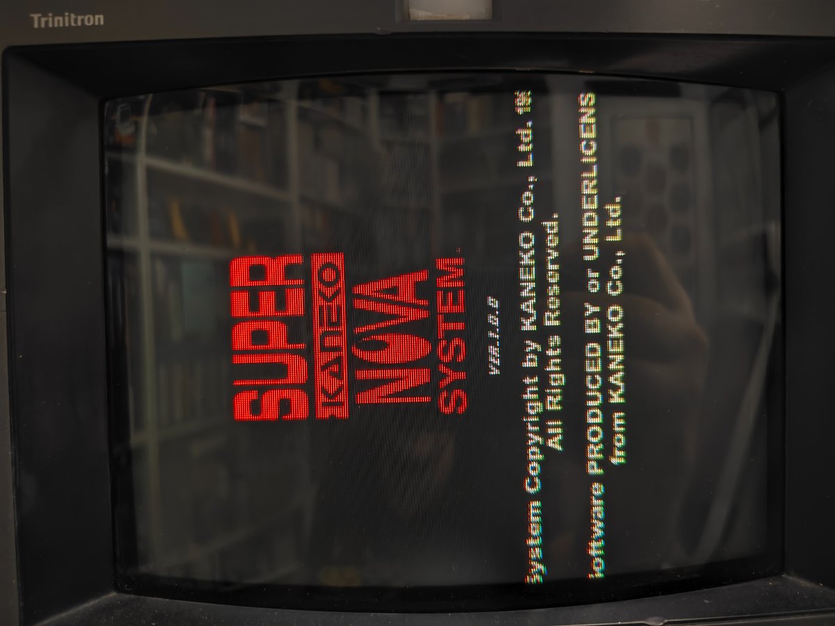

I'm trying to convert a Gals S2 (Rom-4 board) into Cyvern following the instructions.
Everything was fine until this screen where the game seems to bé stuck into.
Did I miss something ?

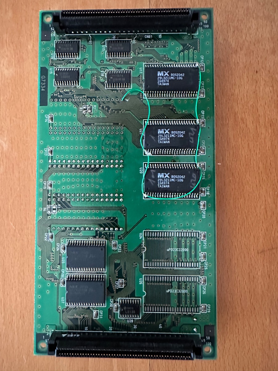

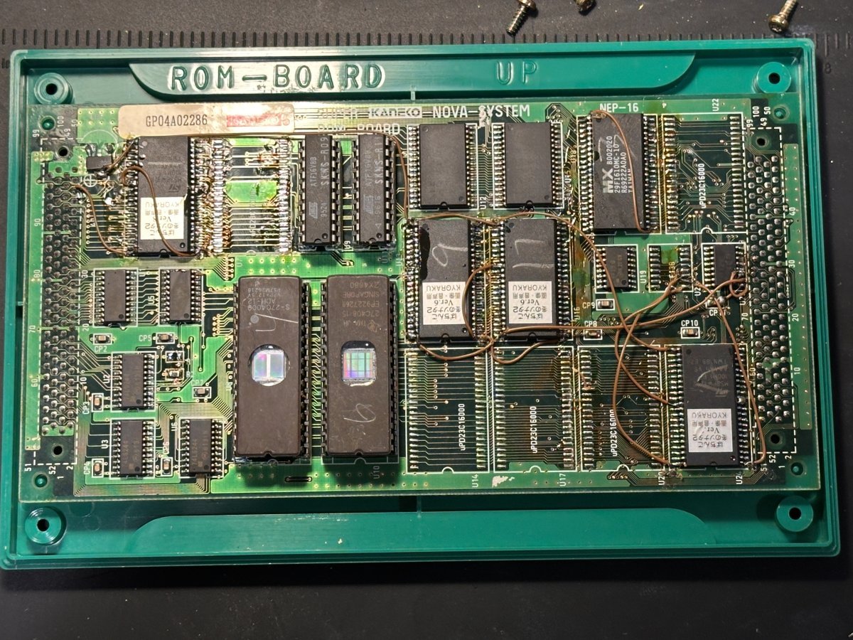

) it was the eeprom in U6 (U10) a 27C801 who was faulty (I don't know for what reason since I've checked it good once after burning it) The opposing, lifted, corner pins (i.e,. PIN1 and PIN23) on the surface mounted SOP44 roms all should be connected back to the 3.3V power source.I wonder if anybody could give me some pointers on a Sengeki Striker conversion? I purchased this from somebody on this forum, but I'm unfortunately missing a background layer on at least level 1 (the holes in the top layer are just black, but there should be ground in them). Here are some pictures of the PCB:
The MX chip (just below NEP-16 silkscreen) in the first pic - it doesn't seem to be connected to anything, but there's a wire connecting two pins on the chip itself. This doesn't seem right to me. Any help would be much appreciated. Thanks so much!

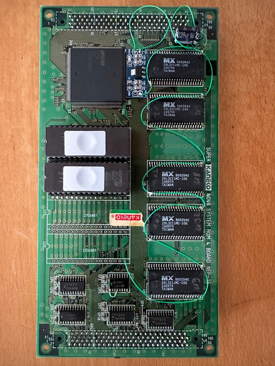

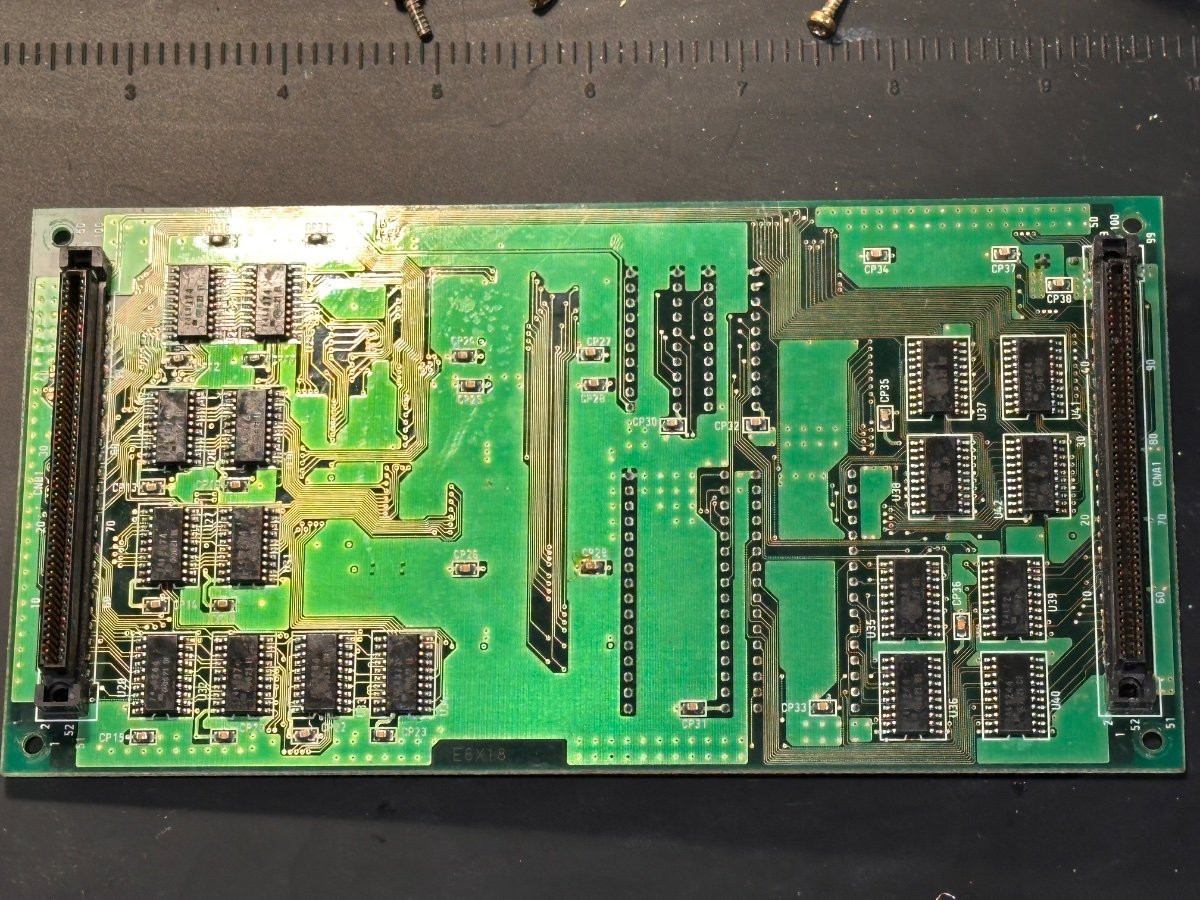

I created a ROM 3 BOARD Cyvern a couple of weeks ago after my dumb ass soldered the ROM chips upside down on the rear of the PCB, de-soldered them, re-soldered them upside down AGAIN, de-soldered them AGAIN, and then finally re-soldered them the right way. I could blame it on being tired, but I'm also quite stupid (as it is apparent from my actions).Hey all, does anybody have pictures of a Cyvern conversion on a rom 3 board?

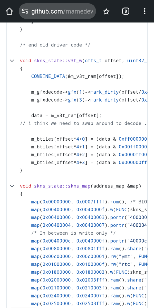

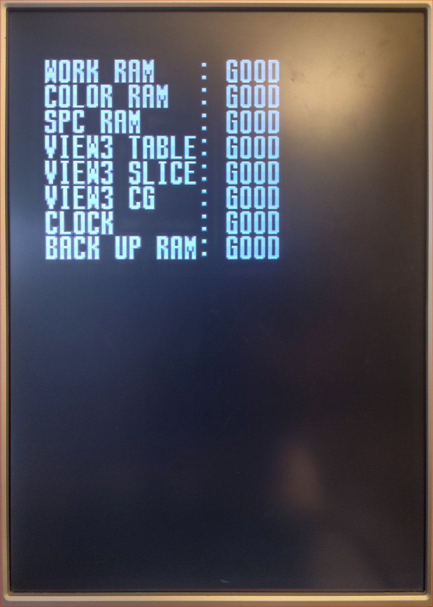

I tried that convert in the past in a ROM-2-BOARD and the test says this:

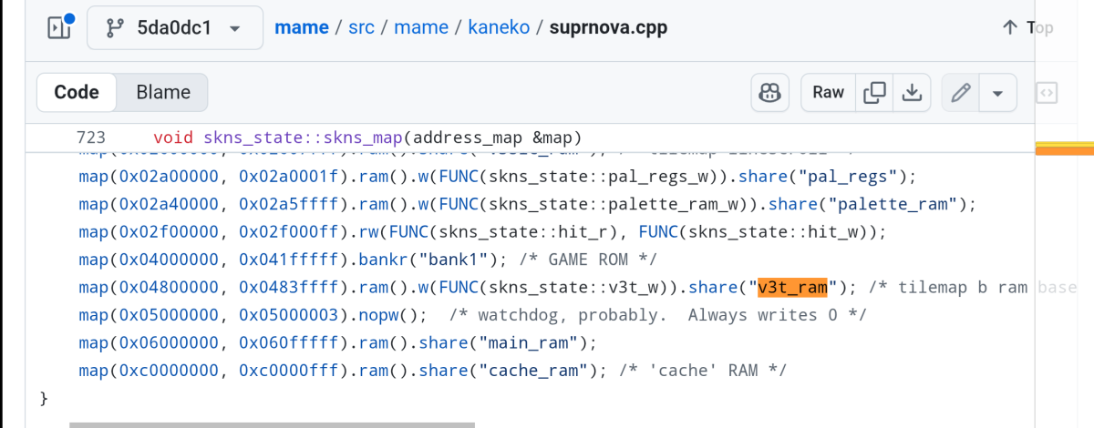

That VIEW3 CG error is related with a 7th graphic ram which is added on ROM-3-BOARD and ROM-4-BOARD.
On MAME driver, says that ram is used for tilemap decoding, because Sengeki Striker uses 4x32mbit sprites roms and 3x32mbit tiles roms: 7 rams needed.
posted an legit ROM 4 board Sengeki Striker - However, their U4/U6 ROMs didn't match the naming in MAME so I'm wondering if they were an undumped revision. I think they were SG* prefix instead of SS*). The issue still persists though with this Asia region cartridge NOT wanting to run on the Japanese main board with any BIOS but happily running on my USA main board with the Japanese Mod BIOS (but only if I use Asia region U4/U6 roms). I'll get some concrete testing done before I report back.So, the chip at U8 - I notice there's nothing there on Nebula's cart, but mine has a chip there. Mine is a JP Jan Jan Paradise 2 as well, fwiw. Do you simply remove the rom at U8?I created a ROM 3 BOARD Cyvern a couple of weeks ago after my dumb ass soldered the ROM chips upside down on the rear of the PCB, de-soldered them, re-soldered them upside down AGAIN, de-soldered them AGAIN, and then finally re-soldered them the right way. I could blame it on being tired, but I'm also quite stupid (as it is apparent from my actions).
Anyway, I followed the images posted by Nebula here: https://www.arcade-projects.com/threads/cyvern-conversion.5886/post-163710
I didn't take any pictures of my work so I don't have anything to show, but I played through the first full loop and it worked/played fine.

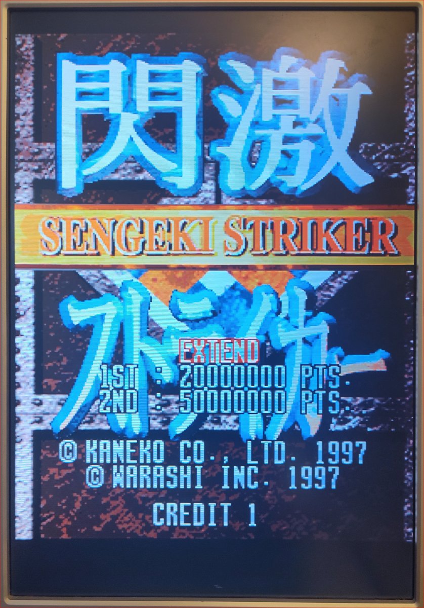

However, and I'll eventually get around to making a larger post about this, I made a Sengeki Striker on a ROM 4 board from an Asia (green cartridge) Puzz Loop ROM 4 board. I actually didn't screw up making this one. It came out fabulously!BUT IT WOULDN'T WORK ON THE JAPANESE BOARD REGARDLESS OF THE BIOS.
So I pulled my USA main board out of storage and ran it with the Japanese Mod BIOS and Sengeki Striker would run but ONLY as the ASIA version. If I tried to use Japanese region 27C801 DIP32 ROMS for U4/U6, it wouldn't run.

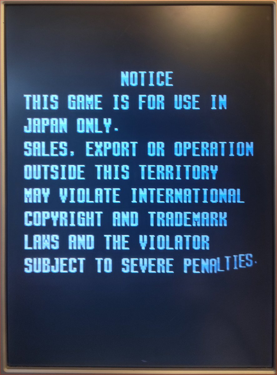

The symptoms changed based on the board region and the BIOS used. The Mod BIOS could usually get the came to kick over to the in game check, but both Puzz Loop and Sengeki Striker gave a "Security Error". Using a non-Mod BIOS would just stall within the BIOS and it would repeat the "only for use in this region" screen.
