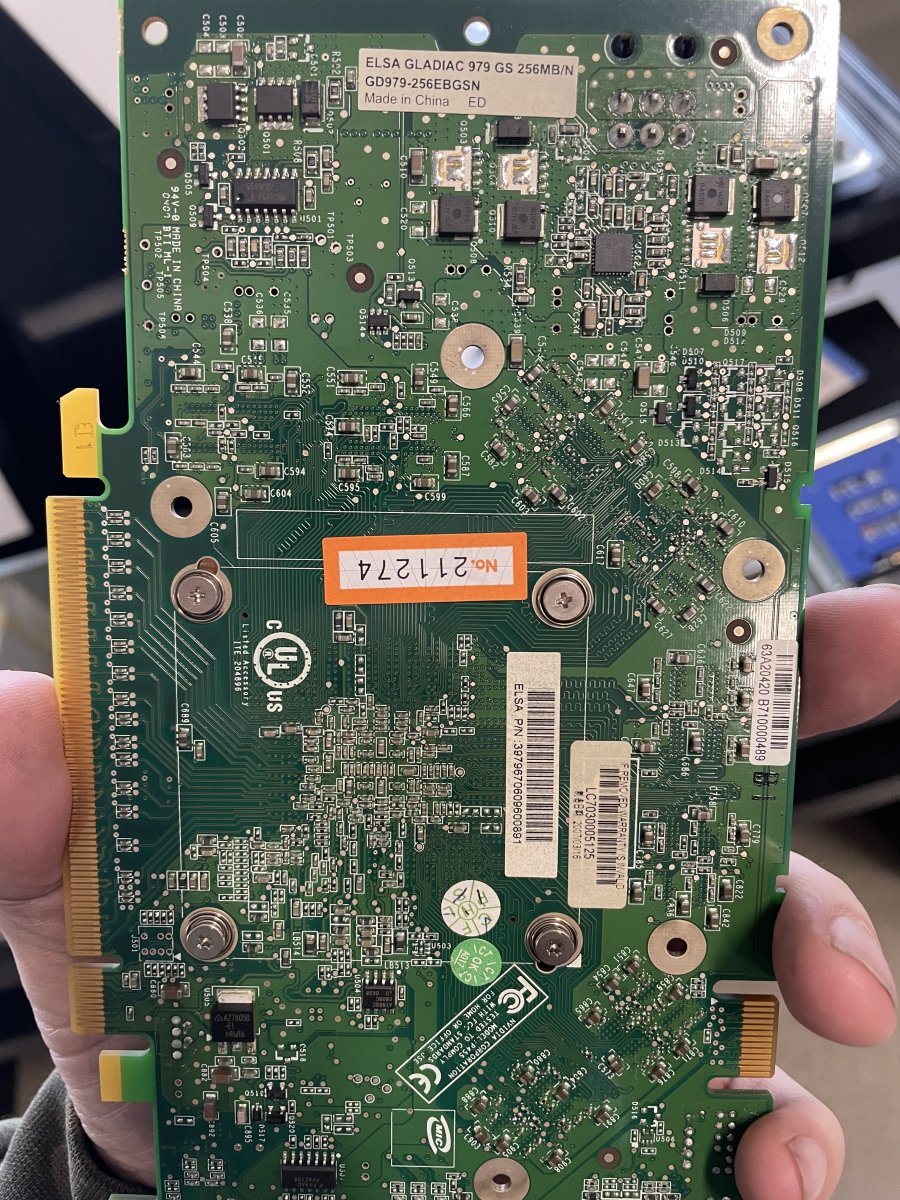

Ok dang.. at this point I’m just gonna flash a new card with Elsa bios is it region specific? Maybe for some reason I have phoenix on some (I’ve never flashed any of these..) my last try i guess before give up lol
I don't know about region specific per se, but the Elsa cards were only sold in Japan AFAIK, maybe other parts of Asia as well. You cannot use the stock Nvidia firmware - the card has to be flashed with the Elsa firmware, or the game won't boot.
You can find a pinned thread on this forum with a link to the BIOS and the flashing tool.

I was assuming this already had that firmware on it but I’ll reflash

Fucking finally got test of the day screen after a reflash. Gonna go test all the vewlix monitors I storage see if I can get two to work

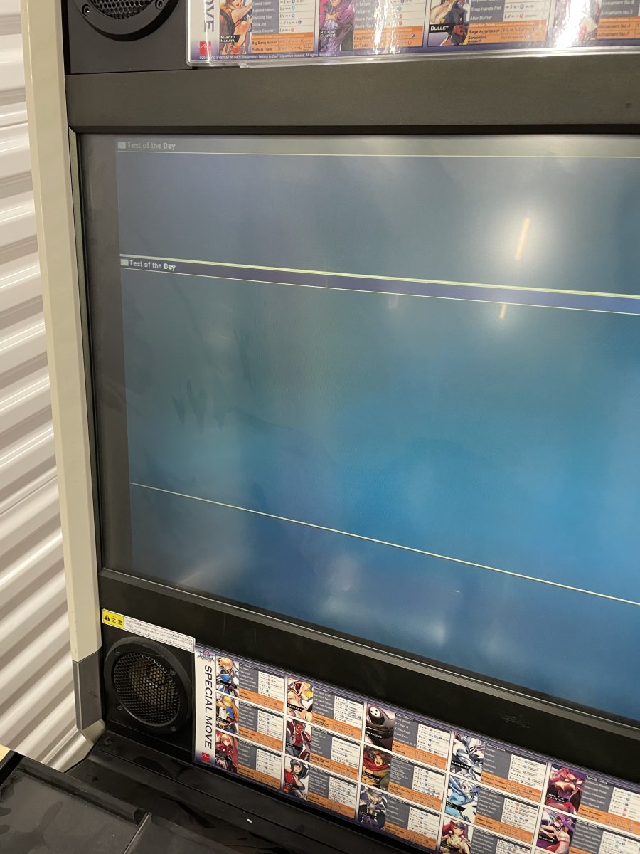

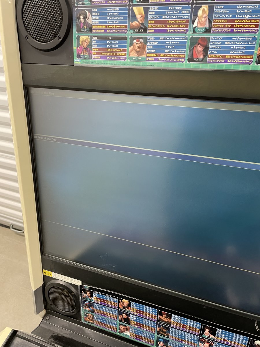

Ok.. so same message on my vewlix Fs & oranges… idk if any other monitors work.. is there a way to spoof Edid with no access to monitors? I didn’t bother testing the blue diamonds. I know about the hdfury dr hdmi but I think you need access to an original monitor to copy? I have one that’s dead I don’t think it powers up..

If it's failing on the other Vewlix monitors then it definitely requires the EDID from the original display. You would need to find someone with access who can dump the EDID.
