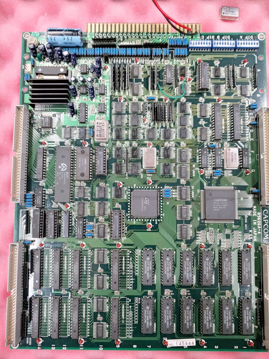

There isn't. The difference as it was already explained is the Main CPU 68000. If you want to convert your PCB, you can change both the quartz and the 68000 processor for one that says P12 instead of P10.There's a thread around here somewhere where someone identified a good heatsync for the A01 custom. But I don't believe there is any difference in the customs between the 10MHz and 12MHz boards.

Heatsinks are a waste of time on chips that barely get warm to the touch. And the CPS1Q case has a fan only because it is closed and may retain heat.
Exactly what Leo said. There are versions of the processor that work at 12Mhz. If you overclock a 10Mhz CPU to work as 12Mhz you may experience issues.So, if you have a 10Mhz one and overclock it to 12Mhz it will run warmer and you risk some glitches (but may not even glitch at all). If you underclock it to 10Mhz it will run exactly like a non dash board. So if anyone want to do a dual clock thing they should be able to, no problem.
