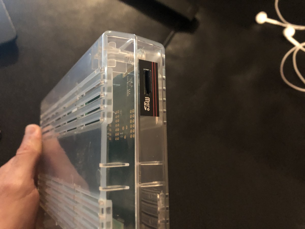

The entire setup was given to me to check. I created a new microSD card and get the same behaviour. The system under load draws about 5.05V. Also, this MVS does have Unibios V4 installed on it already. The net of it is that it behaves exactly the same if the Darksoft cart is installed or isn't installed; you get the cross hatch pattern on screen as if there's no cart present.
I will next try the darksoft on my MVS in the arcade machine. I don't think there's anything wrong with the consolized MVS as it plays original carts and 161-in-1 perfectly fine.
If I understand correctly, the Darksoft cart should still work, even with the Unibios V4. correct?

Since it isn't operating on two different MVS boards, it sounds to me like the Multi cart is bad, unfortunately. Normally the cart will apply the updates and remove the "update" files from the card. If the "update" files are still present on the SD card after letting it sit powered up for several minutes then the cart isn't executing bootup code. The file system layout in the screen shots looks correct to me.

It really seems like the Multi is unable to see/read the SD card, potential damage to the card port?
As no files are deleted, I'm assuming no updates are being preformed and this might be a reasonable explanation as to why.
