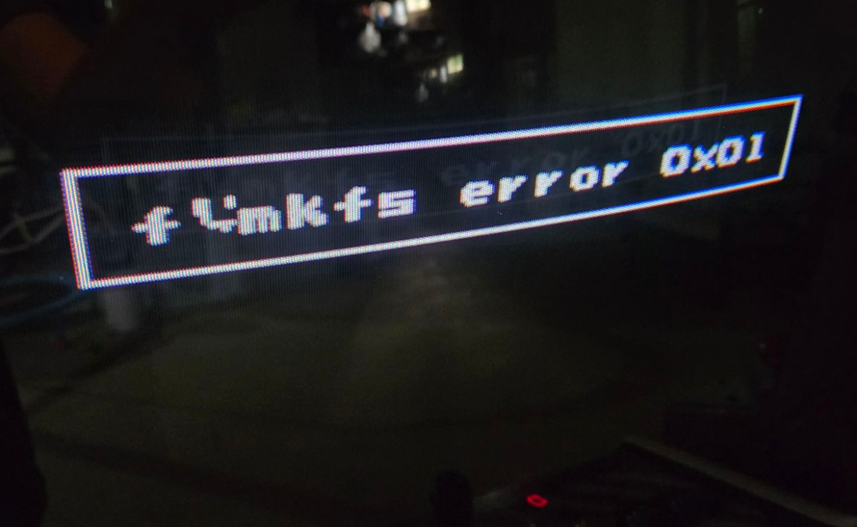

re: Windjammers, try a different region, just in case. Or another motherboard also to isolate the issue. It might also be worth refreshing your backups, or trying another SD card also.
