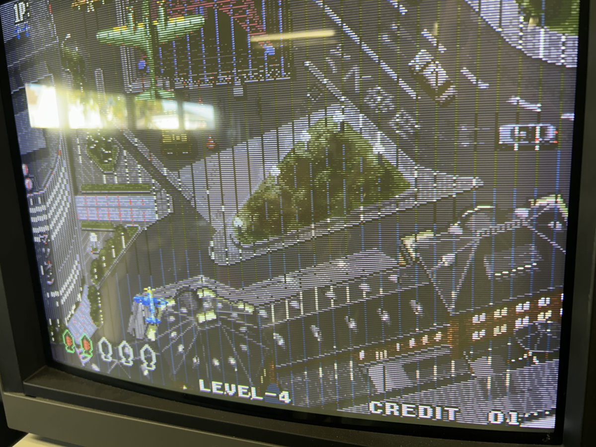

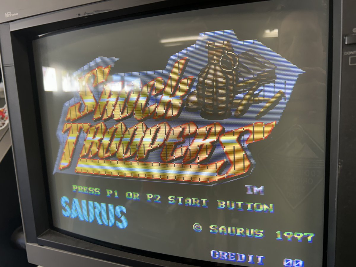

I'm having some trouble with my MVS Multi. Previously it had been working perfectly fine for years. Unfortunately now I am experiencing graphics issues. I've tried testing it with a friend's MVS motherboard, and I experience the same behavior.
I tried cleaning the cart and the motherboard contacts really well with both isopropyl alcohol and deoxit, but it hasn't helped. The same type of graphic issue appears across all games and the multi menu.
Here's an example of the "jailbar" looking sprite issue.
Please let me know if you have any suggestions for further troubleshooting, or maybe there's a way to repair this multi if a chip has gone bad or something like that @Darksoft ?
Do the exact same behaviour happen in both MVS mobos? same amount of lines bad? To me it looks like a bad buffer or made one of the RAMs.
yes, the behavior is the same on both motherboards. And testing with a regular MVS cart, I don't receive the graphic glitches on either motherboard
Then must be the cart. Maybe is a firmware glitch. You could try programming the TOP file again and see if it changes anything. Make sure that you use the latest FW + TOP (they go together) and use the MVS version, not the AES. Once it's done let me know how it goes.
I just tried reflashing the firmware (and menu), but no luck. Same behavior unfortunately.
