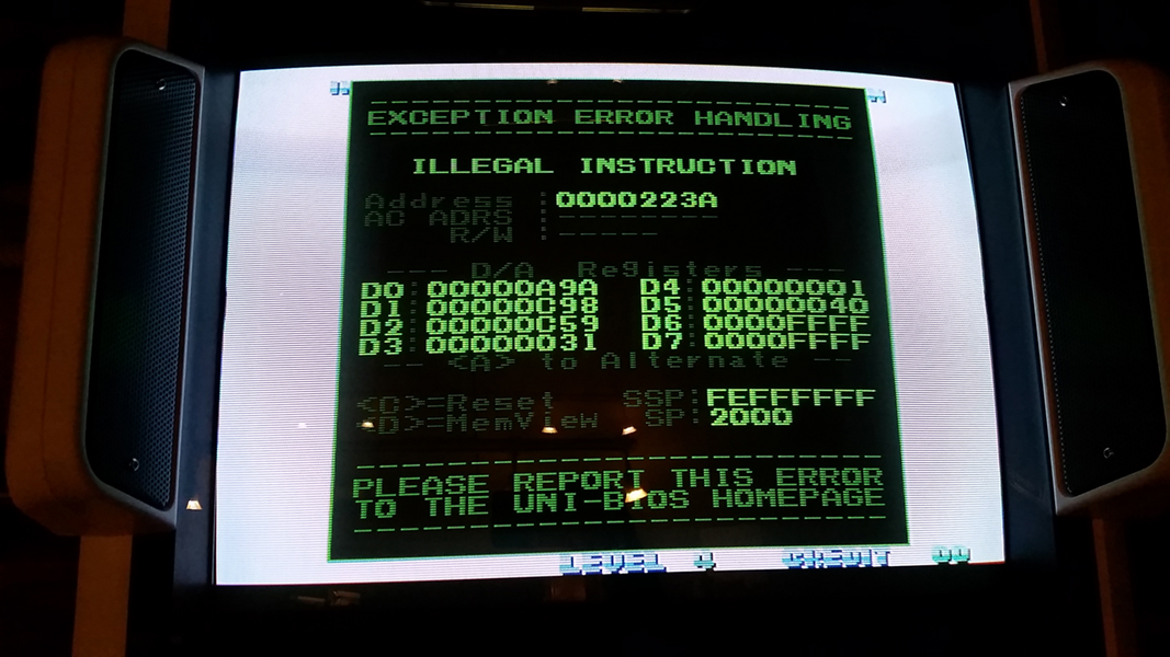

I came back and powered it back on and all 3 games were still there, I played a few credits of Aero Fighters 2, then switched to CyberLip and played a few credits of that, then I switched to Twinkle Star Sprites and it crashed immediately when loading the game:
It wouldn't soft reset back to the menu nor switch slots so I had to power it off. When powering it back on it once again hung on the initializing filesystem message. I rebooted again and it booted the the menu.
