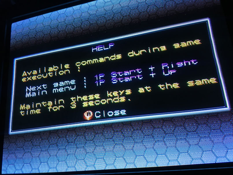

Another thing, the text on the menu says to press START + RIGHT to load the next game and START + UP to go to the menu, however on my cart it's reversed! START + UP goes to the next game, and START + RIGHT goes to the menu. Is this a known problem or any ideas about that?

It is supposed to be like that. Start + up = next game and start + right = menu. Unsure why it mentions the other way around for you, didn't notice that myself. Which version of the menu are you using?
Using latest firmware, attached is the photo of the "help" screen from the main menu.

on my cart:-
Menu = Right & Start
Games = Up & Start
Never seen help screen but IMHO feel it' just got mixed up. Am sure it will be sorted in time.
Ps. I feel up should go "UP to menu" and right ( or left ) Side step cart slots.
