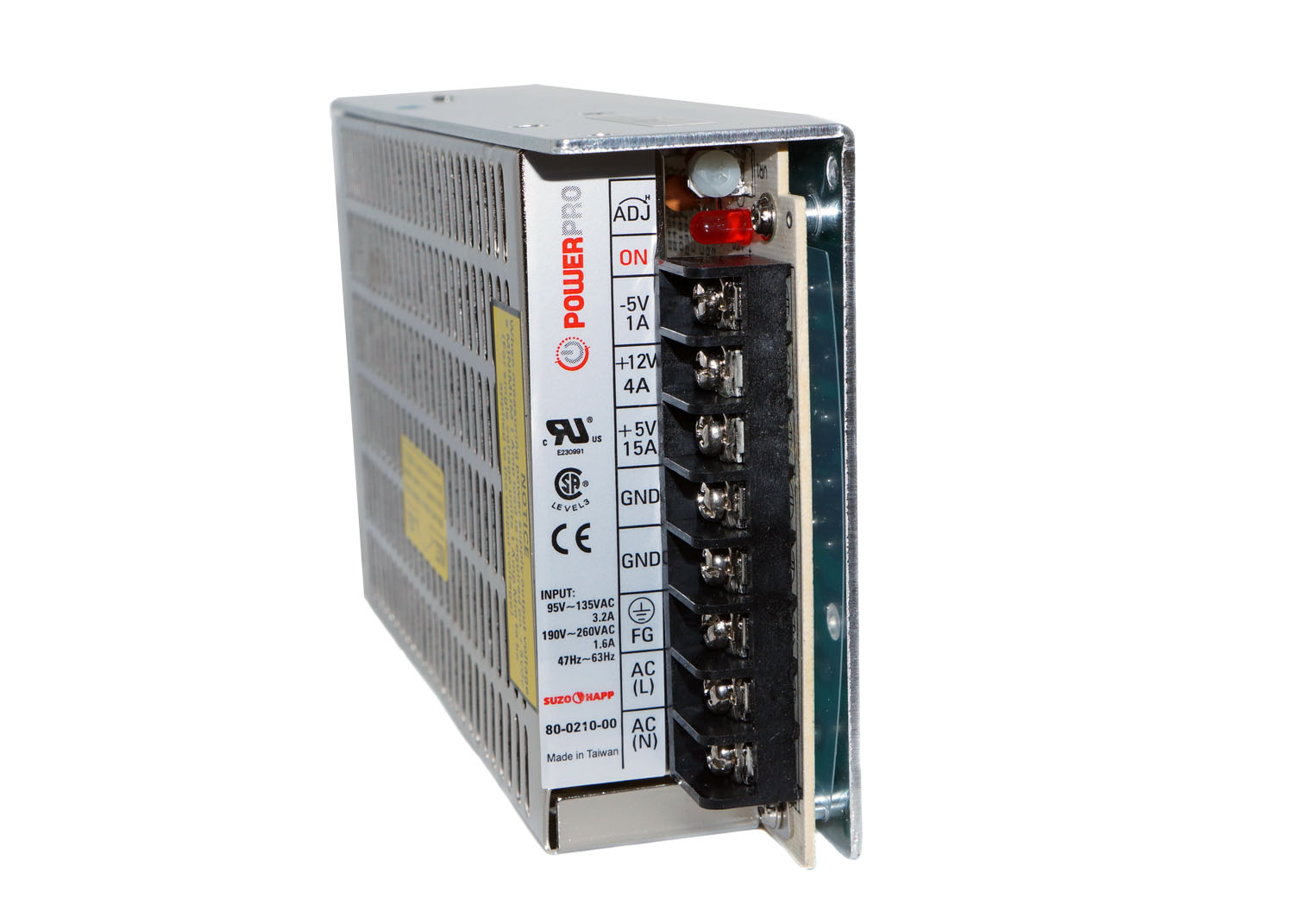

Ouch, no way that PSU is pushing enough (it says 2.5 but I've known these to be very weak) amps on the 5v line to keep everything happy.
I'm kinda surprised you haven't had any issues (random reboots) with legit carts.
I highly recommend the Suzo Happ 130watt PowerPro PSU...
The best thing about these PSU's is the ADJ (adjustment) pot.
Some of the nicer PSU's have independent (5v/12v/-5v/3.3v) adjustments, but I haven't had any issues (aka sometimes boards want more 5v but not more 12v) with this single one.
BTW, do you see the amp count on the 5v line of this PSU? 15 vs 2.5

Bingo. I'm kind of surprised a supergun builder would include something like that. I doubt it could power 25% of my boards.

I really love @RGB 's HAS (Home Arcade System) 3.1 paired with the Suzo Happ 130watt PSU above.
