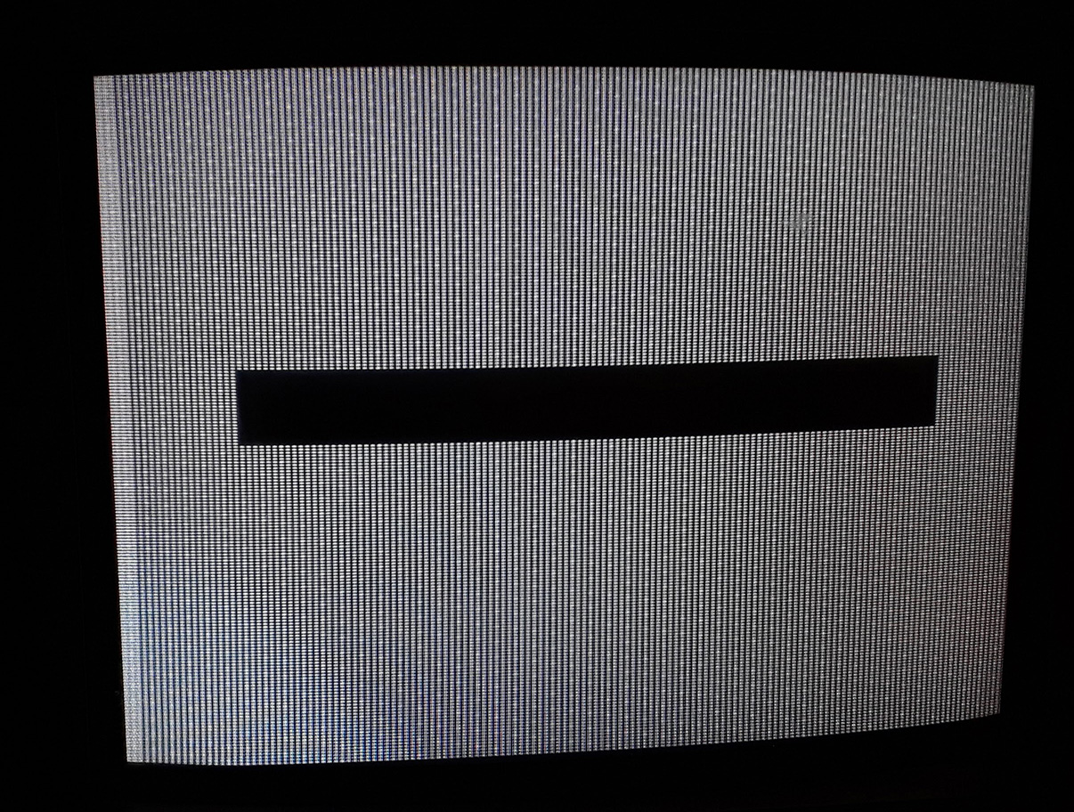

UPDATE: I emptied all slots and changed my game setup to: (1) Blazing Star, (2) Metal Slug 3, (3) KOF 2003
it ended up with this freeze screen :(
After switching off and on again, the menu showed all the 3 games in its slots.
I didn'T start any of those, emptied the slots an flashed again in a different order.
It worked, the procedure looked like this:
https://drive.google.com/open?id=1W8zcqLR_NOsXDqNfvNZGIz9fogBU0mHD
Same as #1. Either your mobo isnt working properly, you dont have the latest firmware or you have a problem. If it's a power problem cutting the trace close to R193 would fix it. *IF* power turns to be the cause, it's an easy fix that you can do yourself or you can send it for fixing.

EDIT: got this freeze today while changing GAROU to WINDJAMMERS in slot 2,
other slots unchanged...
EDIT 2: I applied the power glitch fix, carefully opened the case etc. abnd cut the trace as described.
No change, still the same pixels while flashing similar to the screen above... :/
