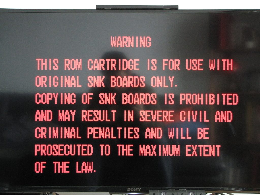

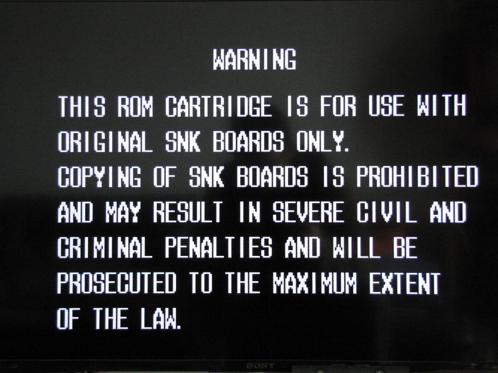

I have a problem with my multimvs. I did the last update of the menu and the firmware, since then, most games I start are stuck to this screen :
or
...then the game is stuck, no input works anymore, I have to power it off.
I use a MV1C, with Unibios 4.0 (I also tried 3.3).
For information, after having those stuck screens, it does the same with original games, unless I do backup ram cleaning.

its nothing wrong with the cart the latest menu update broke compatibility there working on it for right now change the unibios from arcade to console and everything will work perfect
