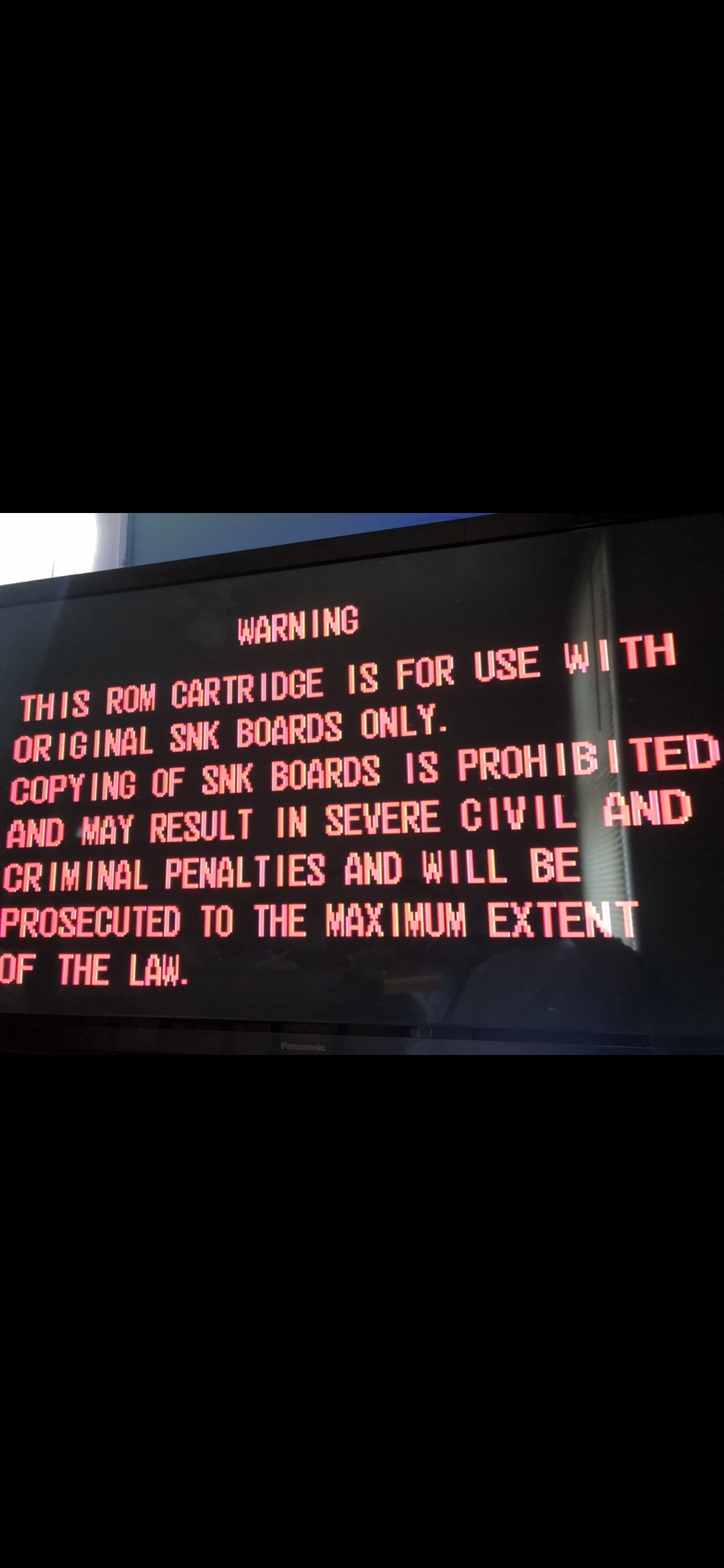

Garou kof98 kof2000 kof 95 kof99 kizuna funny thing you get the neo geo chime then boom red screen of death lol console moe trick still works and i forgot to mention im on unibios 4.0
I've tested also on unibios 4.0 and no problem there. It should work. Did you delete buff file and clear backup ram in the right order? Plmk.
I'm assuming that you have a working battery on the mobo. Can you please check that as well?
Yes I have a working battery the date and time is always accurate and my region setting always saved I’m going to format card again and start over so you want me to do flash file top file then menu and delete buff file after each one is done and clear backup ram after each is done if that’s wrong can you instruct me on the order of how I should set this up appreciate it in advance

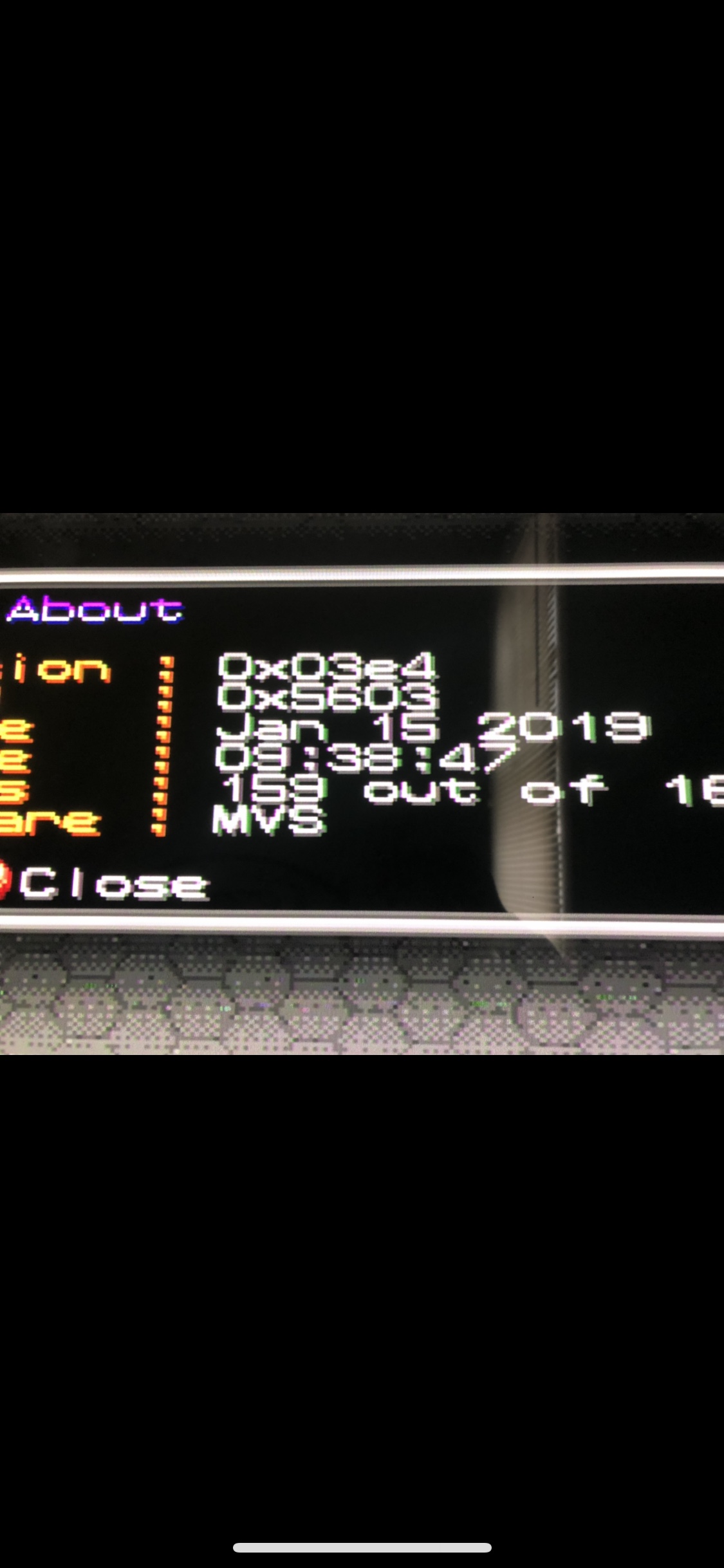

works well here. Can you actually check in the menu which version is displayed in the about section? Are menu files deleted from folder /update/menu
`im working on everything as we speak just formatted card
all files in update gone when i update the menu from the smoke monster pack and didn't use the latest flash and top file menu worked perfect kof98 booted up but i lost ability to to back to menu then when i updated the flash and top to the latest i get red screen of death @Darksoft
i don't know whats the difference in the april menu but that one works

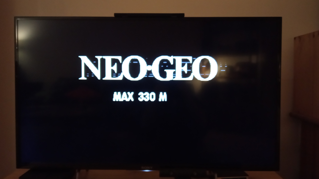

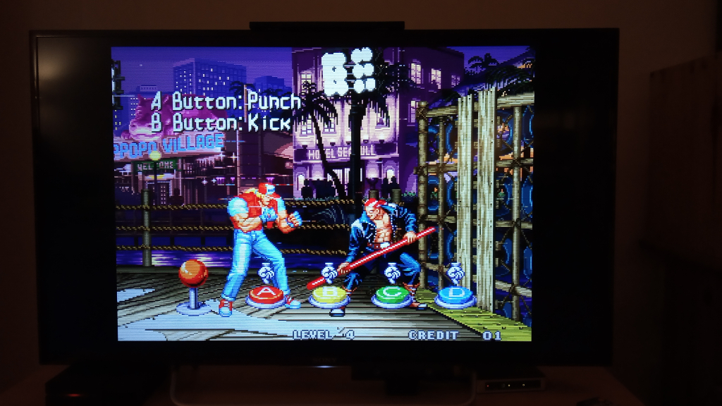

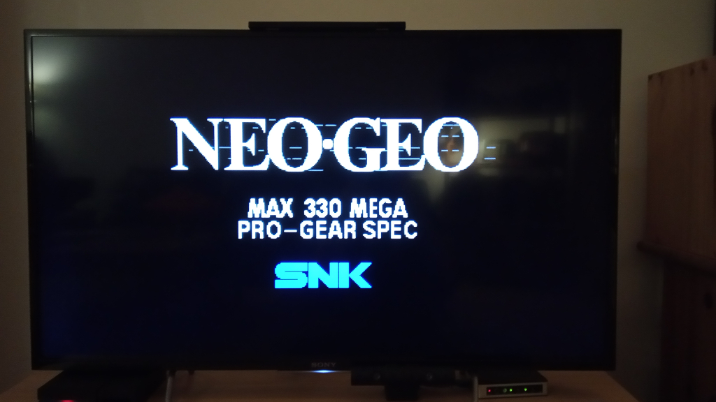

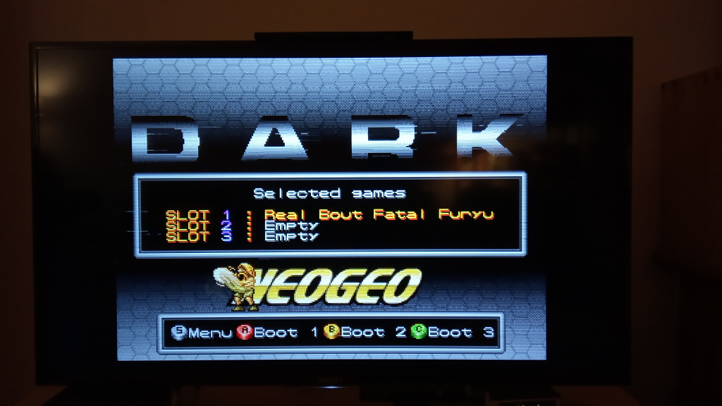

I also tried with my MV2FS (first with Unibios 3.3, then I put Unibios 4.0), there is no freeze screen contrary to my MV1C (with unibios 4.0) with the last menu you uploaded, but I have a glitchy display, as shown below :
https://www.arcade-projects.com/forums/index.php?attachments/16062/img]
[img]https://www.arcade-projects.com/forums/index.php?attachments/16061/img]
[img]https://www.arcade-projects.com/forums/index.php?attachments/16059/img]
With a regular cart, there is no such glitch, and when I used a regular cart in port 2 (Viewpoint), I only had a little of this glitch on the "sammy" screen.
