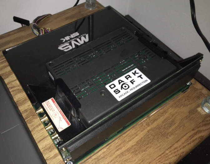

Maybe it has been mentioned before, but is anybody having music tracks cut out once in a while? When I play Neo Turf Masters or Metal Slug 1 sometimes the music will cut out until a new track loads. Sometimes just part of the music cuts out (high end will cut out, baseline cuts out).
@mukurofish is this happening on MVS or AES console ?
@Darksoft It’s happening on an MVS. I just put it into storage (my move to Japan is happening in a few weeks), but I can take it out again and try to get a video. It doesn’t happen every time, but every few days it was happening. Would having a Unibios have anything to do with it?
Same here with stock bios and unibios

I updated the FW on mine around March. I'm not sure if that's the most up to date or not. I've been kind out of the loop on everything between school, getting married, selling my house, prepping to move overseas, etc. Since doing the update it was happening less often than before though.
It happens less frequently with new firmware, and i also have random pcm audio bug like in this video at 5:05
youtube.com/watch?time_continue=307&v=jwHHIpLcjdE
After more test, i had a lot of theses 2 bugs (pcm audio and music and sound disappear) with kof97.
MV1F stock bios and unibios latest menu & firmware
After more test, i had a lot of theses 2 bugs (pcm audio and music and sound disappear) with kof97.MV1F stock bios and unibios latest menu & firmware
Come to think of it I had A LOT of trouble with KoF97 as well, and sometimes 96 (but never 98 weirdly enough). On 96 it happened on the Korea team stage and Kyo’s stage (that I remember for sure). The music would just completely cut out unlike the problem with Neo Turf Masters and Metal Slug where the high end track would cut out. Do you think we may have got our ROMs from the same place and that could have something to do with it?
A lot of people seem to have trouble with 98, during attract the characters disappear off screen as well as other glitches. I think DS patched most of them though.
I don't know i use smokemonster Neo Geo Roll-Up Pack with a genuine samsung micro sd, maybe it's related to our mvs slot, i saw on your post you seem to have the same slot as i (mv1f ???)
