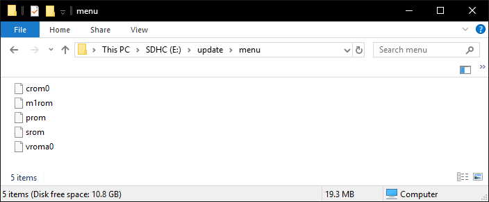

I bought this cartridge secondhand from someone, booted it and it worked fine, but I noticed the firmware was out-of-date, so I decided to update it. I did was I think was right by deleting the BUFF file, placing the files inside menu_20190324 in /updates/menu, clearing backup RAM on my MVS, and then plugging everything back in and powering on my MVS. Every time I plug it in now, the MVS boots to the test screen. I verified the MVS still works by testing a few other cartridges.
Attached is the picture of the contents of /updates/menu
What am I doing wrong?

the files of the menu should be on the folder that you show in the picture. No more sub directories, just the 5-6 files of the menu. If the update went well, the folder /menu inside /update should be completely deleted, not empty.
