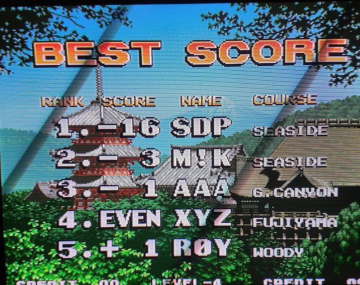

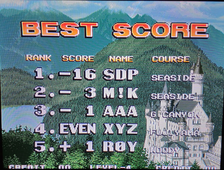

I played a round of Neo Turf Masters to test out my cart.
Here are the results:
Set High Score
Load High Score (power off for 30 seconds)

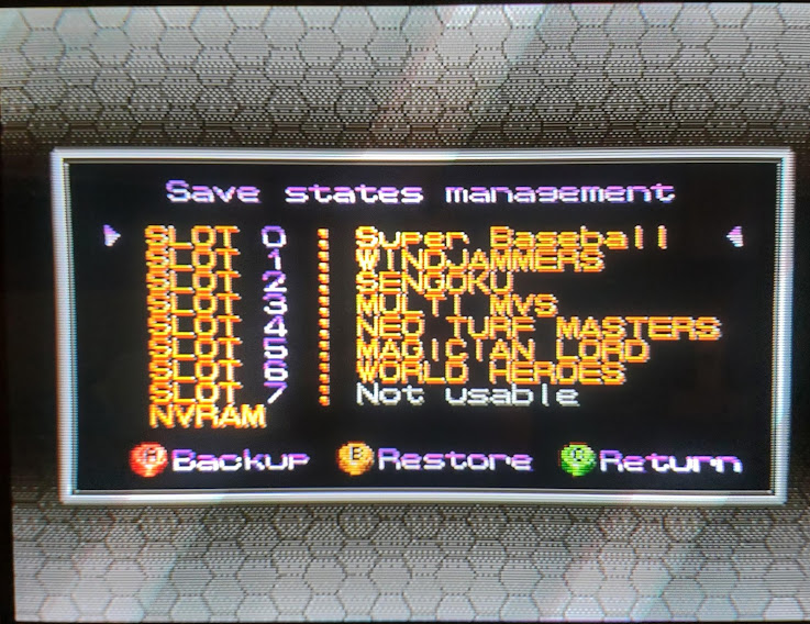

Save Management (item #4)
Check your "Save State" menu and see if it's populated.
This is from the manual:
If it's not, you might want to try clearing the backup ram from the multi-cart menu.

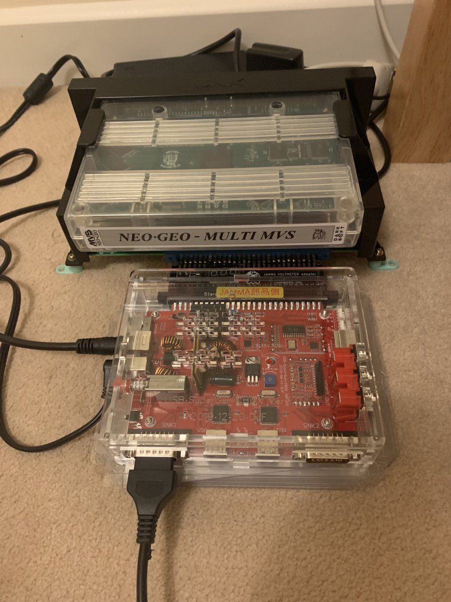

This is my set up and I didn’t know that about the 161-1 cart. I’m new to all this tbh. I have Unibios 4.0 installed

I have a similar Supergun but I've never used it with my multi-MVS. It was my first Supergun and I used it with an mv1c and 161 in 1.
What kind of power supply are you using? What's the amp rating? It's a 12v supply, right?
The Multi-MVS might need more amps than you are getting.
