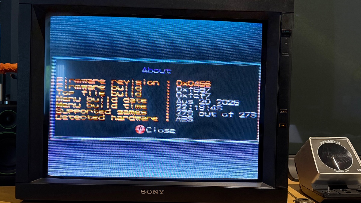

do I understand right that those 2 folders will work well when added to the multi but a new folder called amazoneo will make the menu crash again?
I'm not sure if I follow.
@citroevo did you also update the Firmware? Because they go together. Have ready the one that you have installed right now in case that you need to go back to what you have now.
two more things, does removing any other folder fix it, while keeping amazoneo? If yes, it's the count and nothing to do with that name.
and what happens if you rename amazoneo to zamazoneo or to mazoneo?
I’m going to do these test.
the actual firmware is 0xf5d7

I tried adding the game "amazoneo" (using that exact spelling) and didn't have any issues.
I then added the "240p Test Suite" without a problem, but I ran into an issue when I added "19yy."
It is possible that this is related to the maximum number of games allowed; in my case, I have to stay at or below 279 games for it to work.
The firmware is 0x456 which is v1110 (in decimal). Current firmware is v1169 which should show in the menu as 0x0491
Try updating that and let me know.

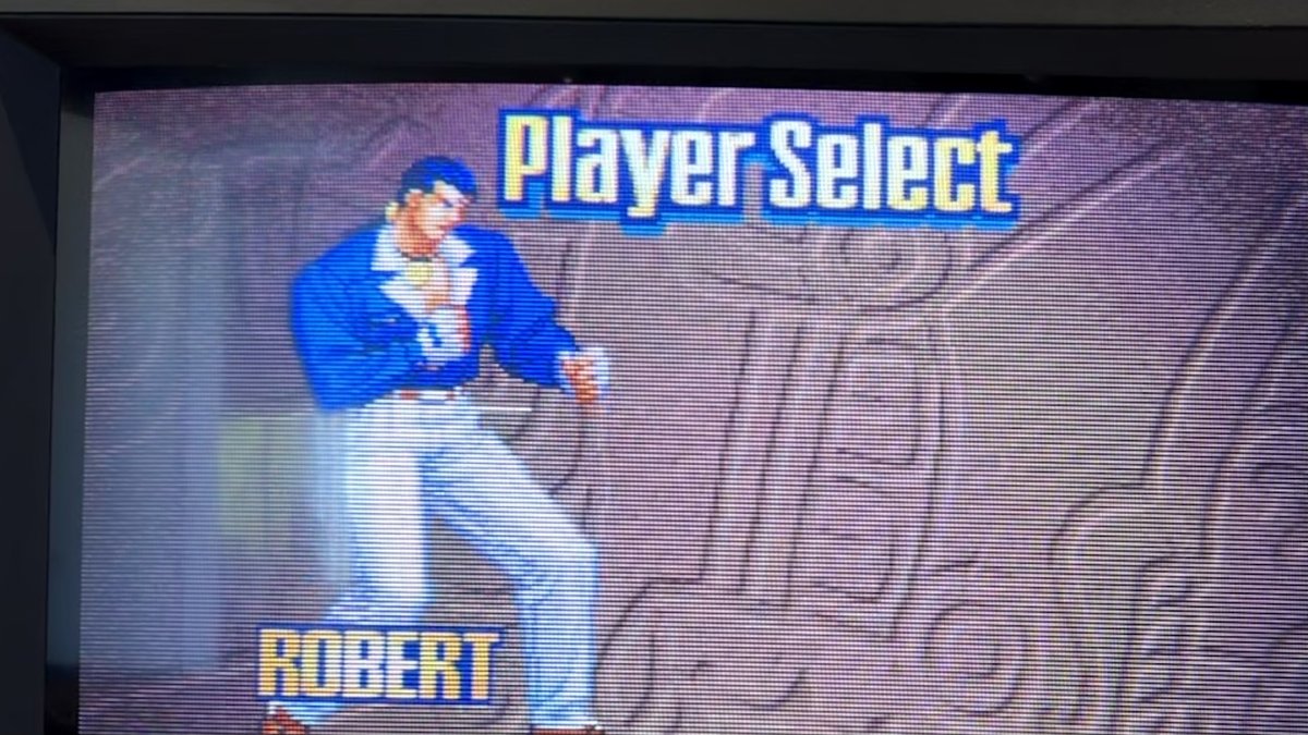

i use this firmware beacause the last one gived glished. I have not try whith the last menu
I have no graphical glitch with The firmware is 0x456
The last menu is the one that allows for any games to show up.
and if you revert now to v1110, it will show proper gfx but will have issues with the menu, right? I'm trying to make sure that only the FW is the cause.
So, I updated the latest menu, for firmware versions v1110 and v1169 menu is blocked ( same problems )
