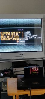

can you document the top, firmware, build versions info just to make sure everything updated properly?
You mean like a PrtScr or just the text int he menu?
If you post a PrtScr like in the MVS section, I'll update it quicker. If not I'll updated tomorrow afternoon.
It's the first 7 points on the 1st post. Basically this:
The info in the About Screen. I forgot to write down what was in there before I updated the firmware. I like to make sure everything updated properly.
