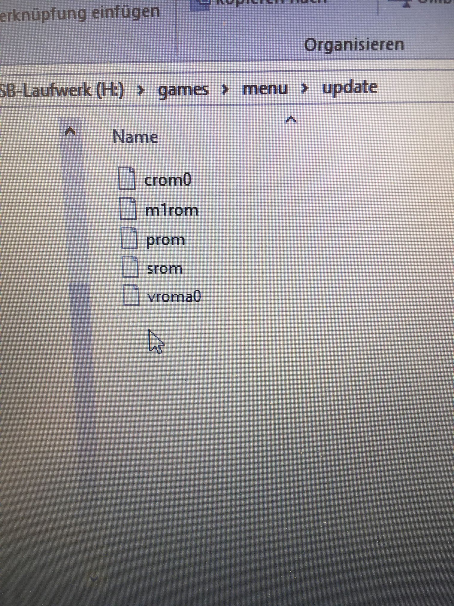

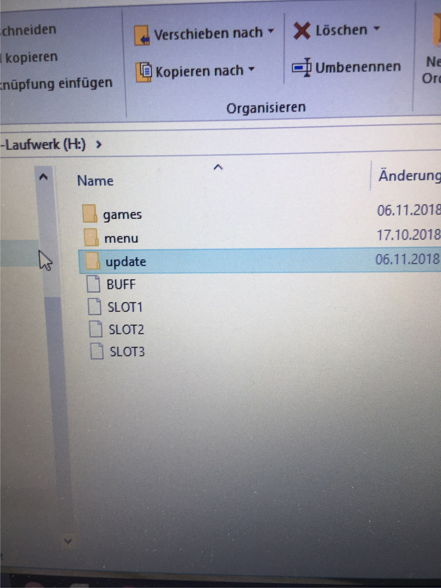

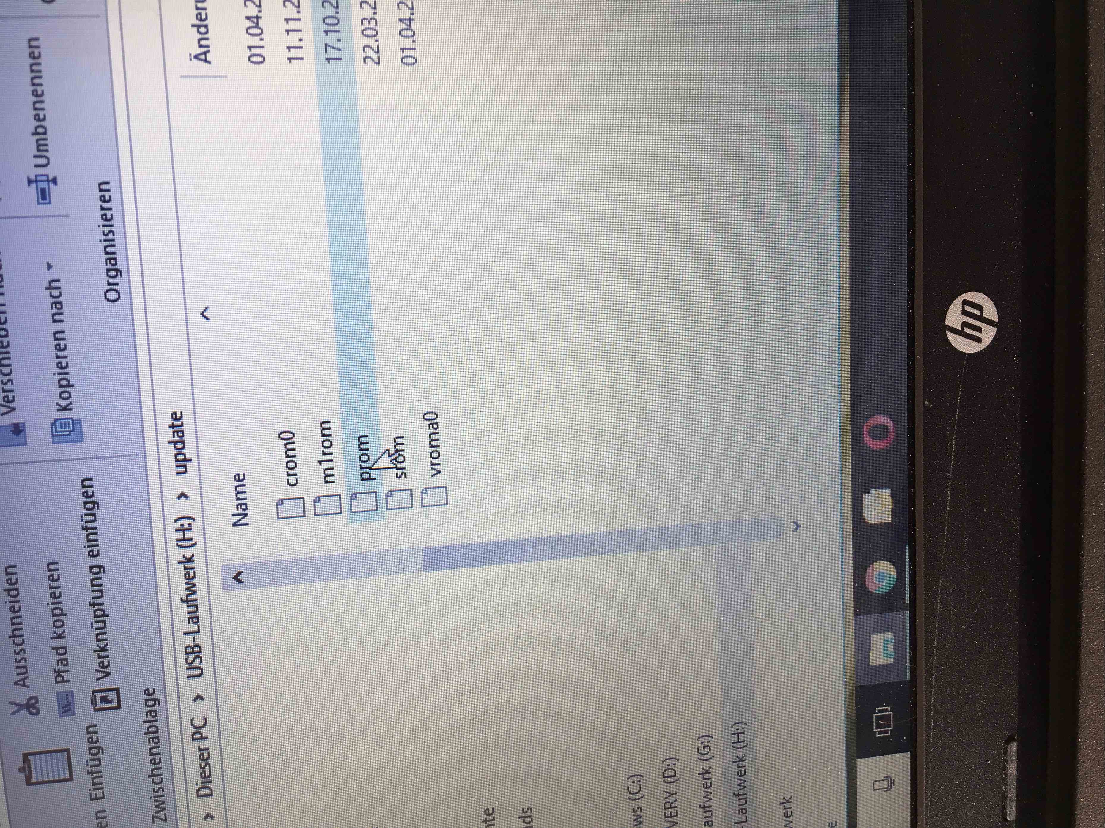

My menu does not refresh. Files in update and menu copied. Buff file deleted and backup ram. Then I put the Multi in the Mvs board.
in that case either something is wrong with your cart or youre not copying the files in the right place. Can you show a snapshot of your microsd /update/menu structure?
Just make sure that there is a menu folder in the games directory, too (it seems to be case sensitive - only lowercase letters).

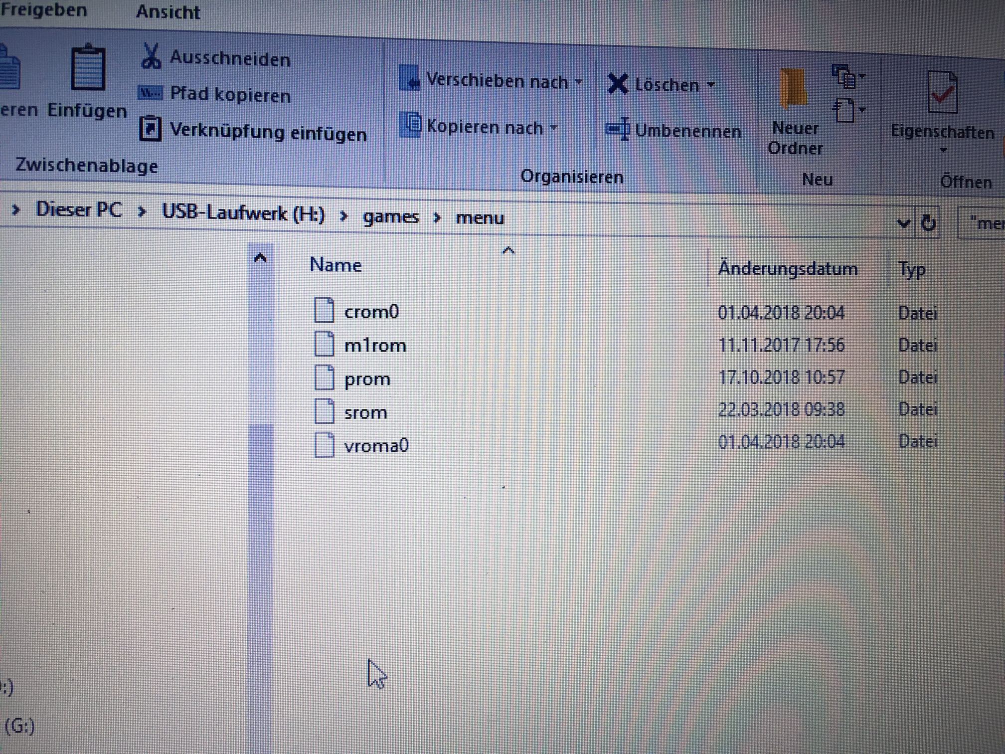

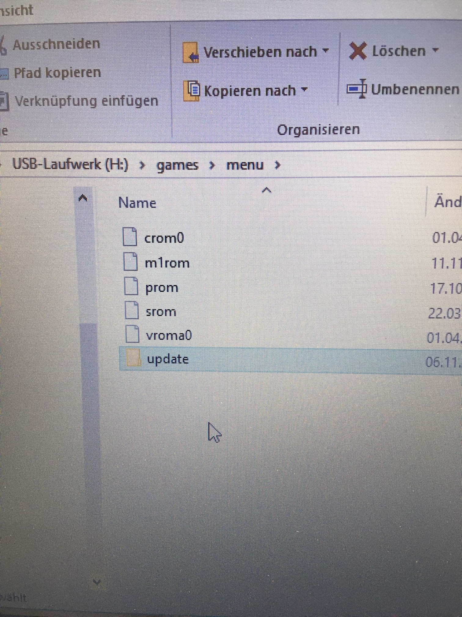

What happens, when you put the updated menu files directly in the \games\menu folder?

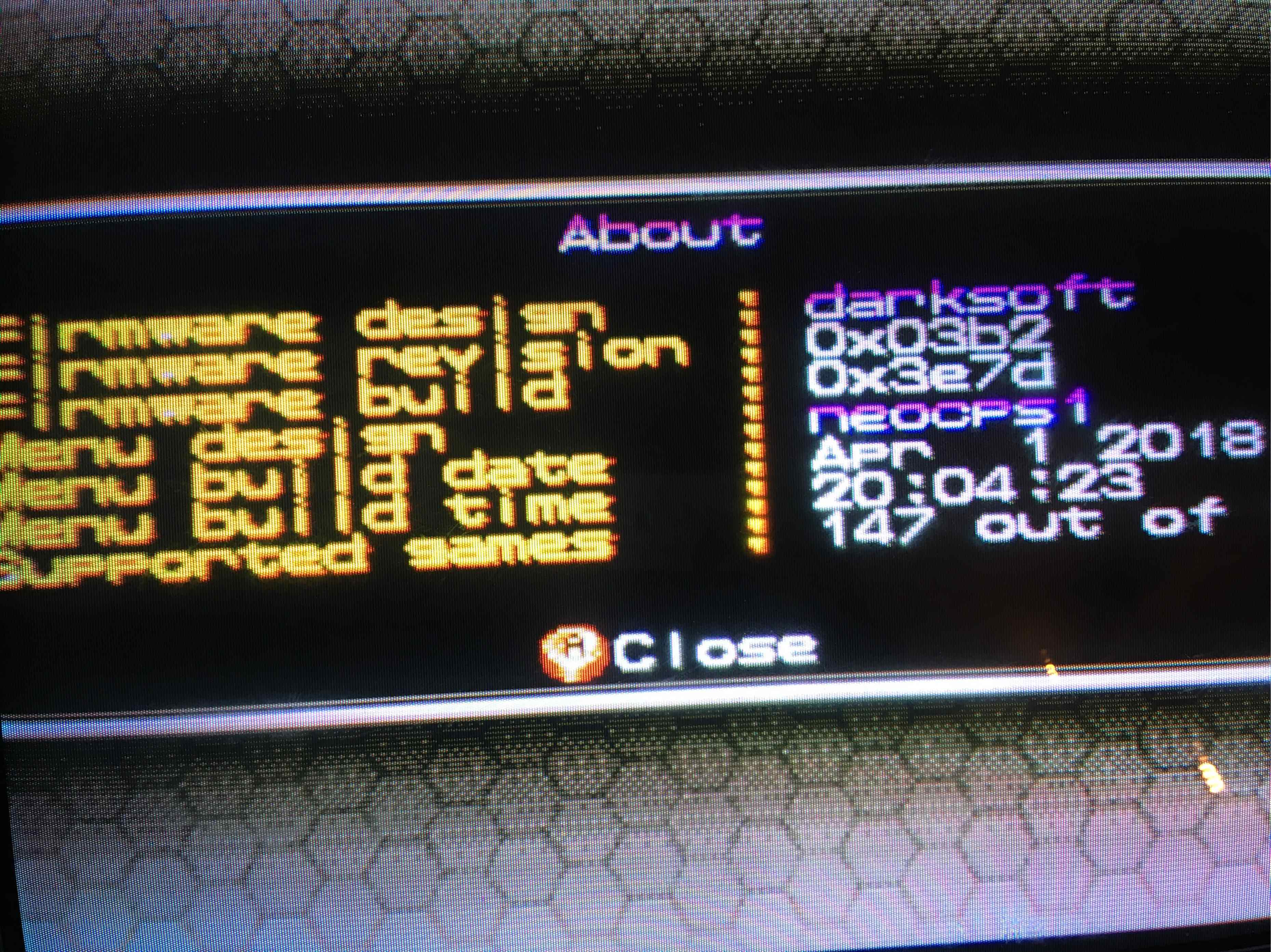

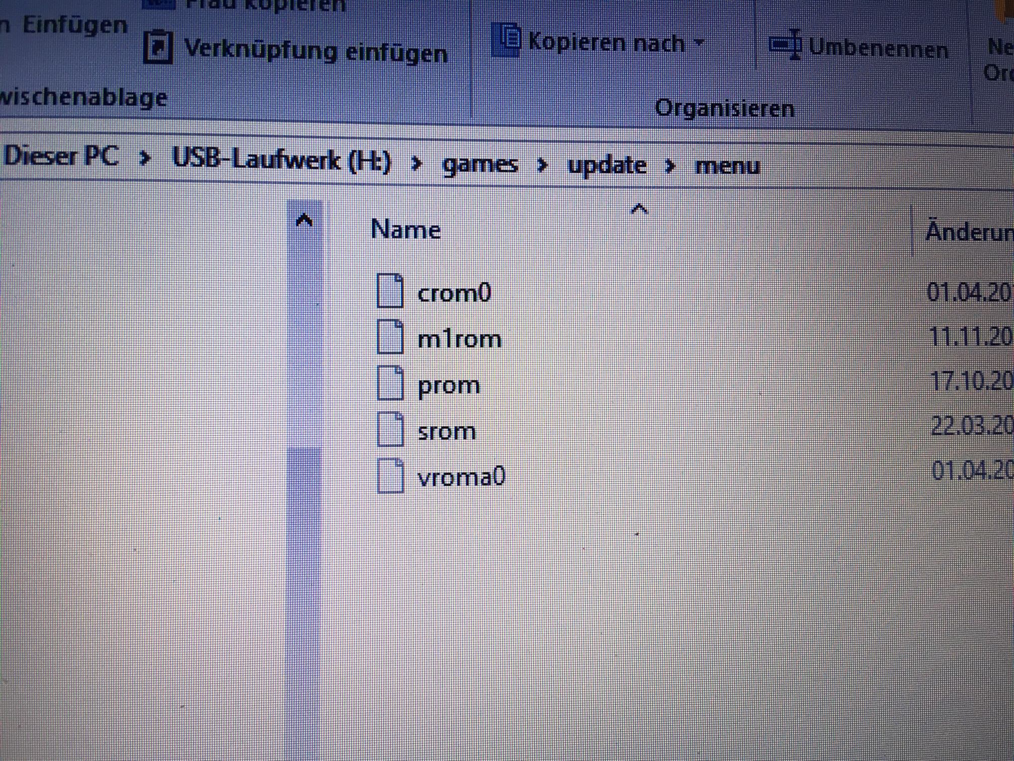

I did it this way and still have the menu from April on it. Was previously synonymous with the updates.
Firmware update is synonymous yes. But the menu update is more. I have menu in games and update also in games. The current menu files are in both folders in it.

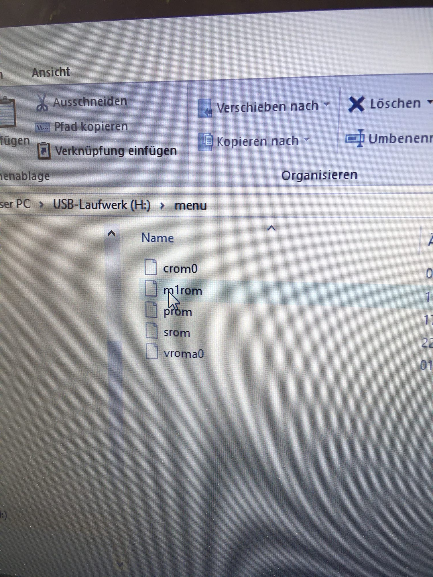

Oh my... no, you don't have to put an update folder in games, just:
\games\menu
\update\menu
you need a menu folder inside a games folder in the SD root
and you need a menu folder inside an update folder in the SD root
Regards

Hi, I've already tried everything with the updates. Before, I was also able to make updates. There is something wrong with the multi
