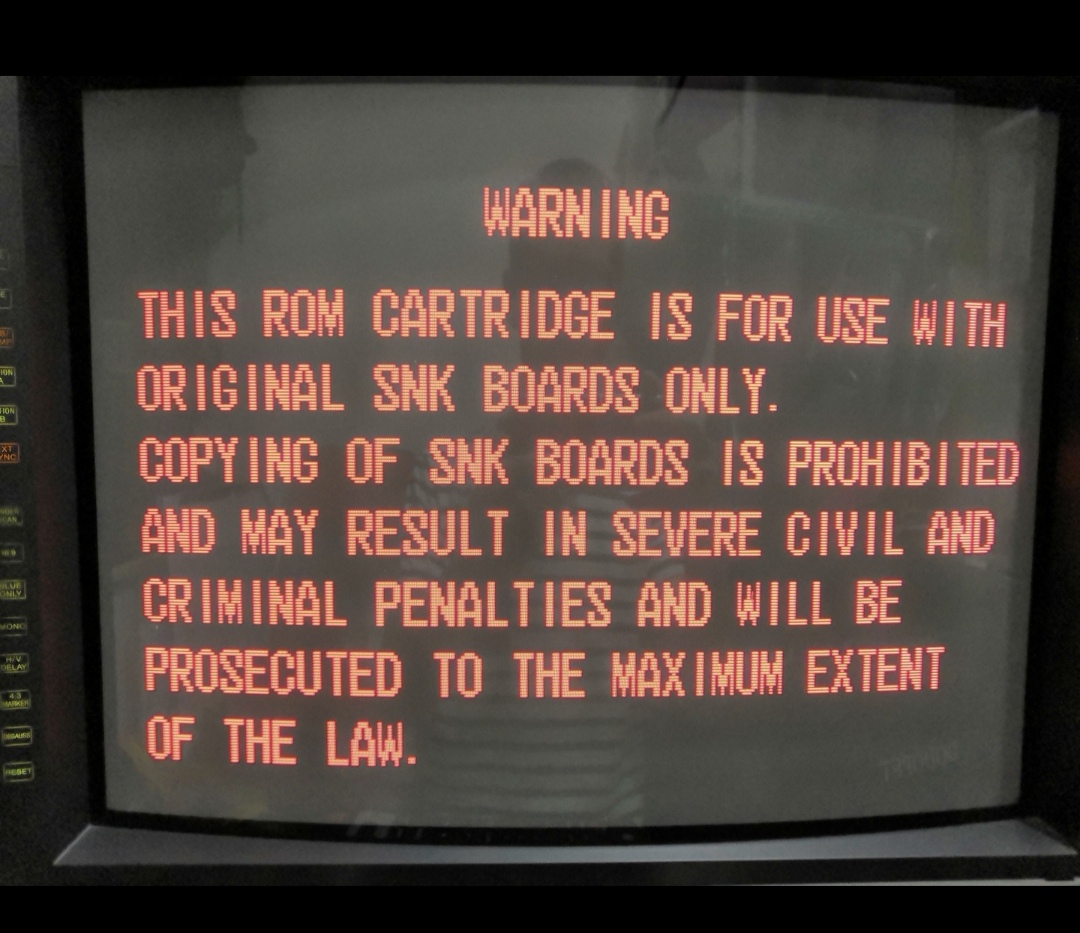

When i update fw and menu, play some game cant run,what can i do?
