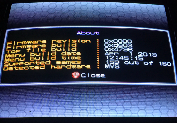

as i told you in private message. My friends system just behaves the same. We have a stereo mvs system. And starting with this new firmware the flashing problems got worse. And also the sound problems. I sent you a video already.
Went down to this version now. The newest menu seems not to go so well with the older firmware you posted.
Hung up every time when the games were about to be flashed.
This combination here did 2 times flash 3 slots out of the box. Only old problem that remains is that the first slot game almost every time has sound issues. They are gone when you switch from bank 1 to another and then back. But I already did a detailed report and video for you @Darksoft
