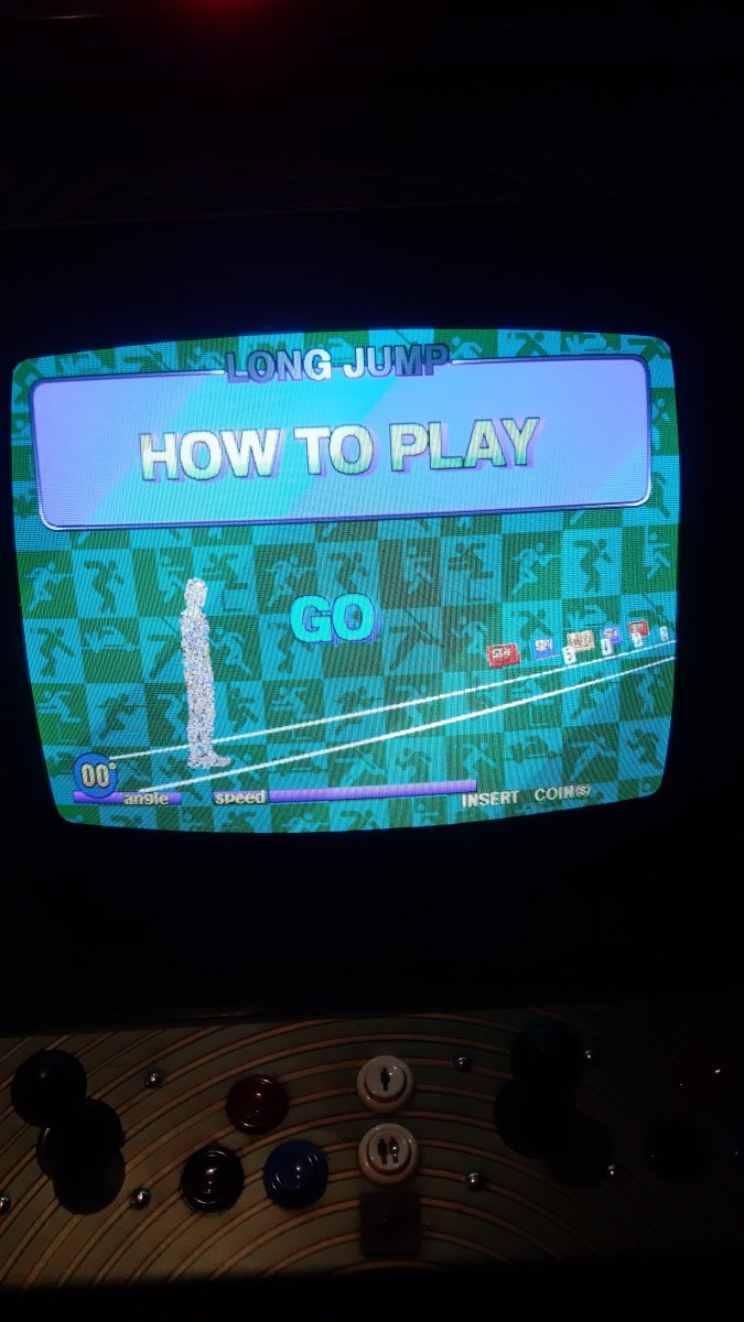

Decathlete for STV finally working!
Yep, the text for long jump, 400m race and Discus throw are bad. Now to find the one player I saw...

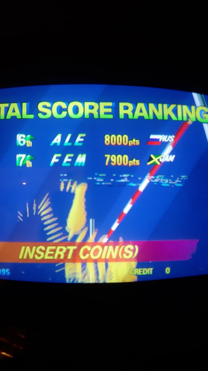

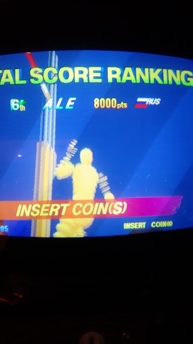

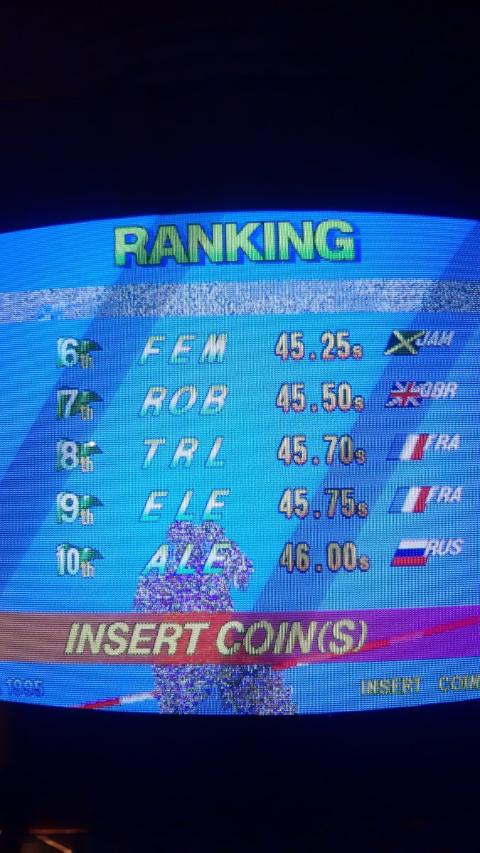

Ok, got him on camera
Shows up right before the yellow figure in attract mode, wich is normal ,I guess

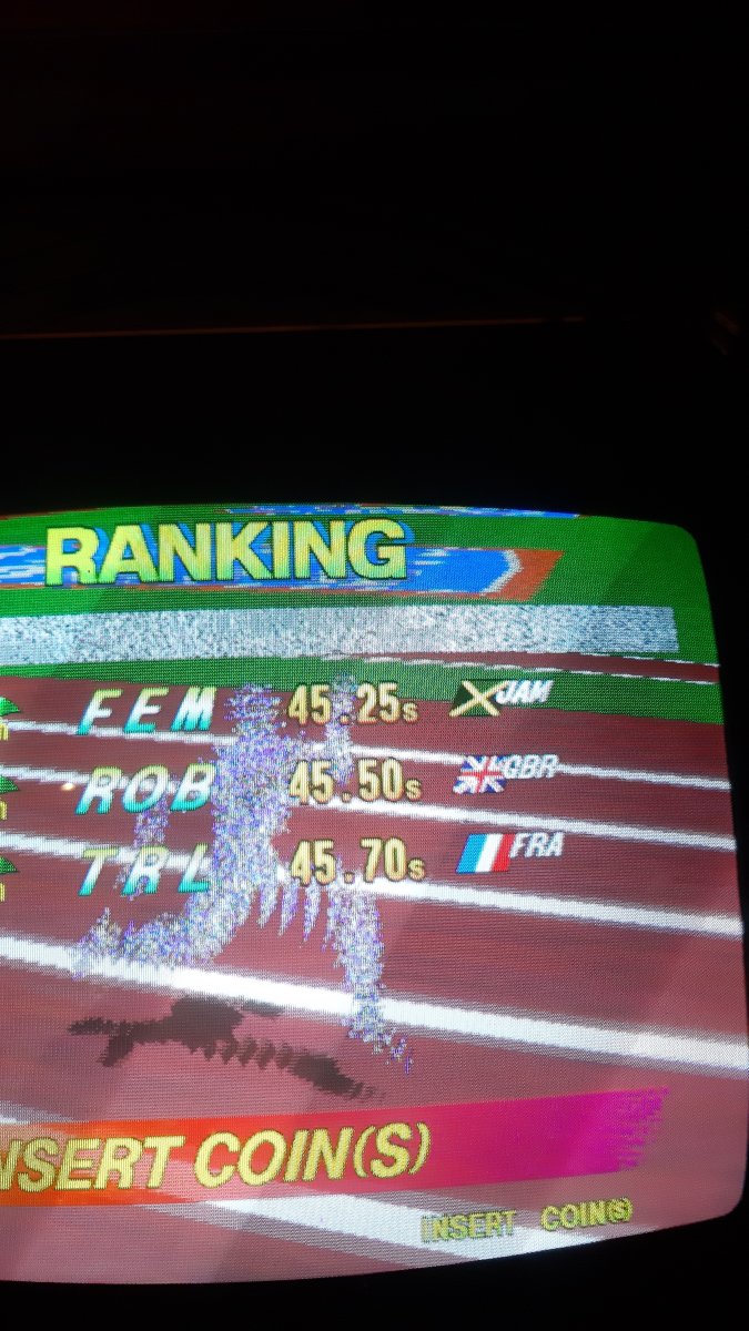

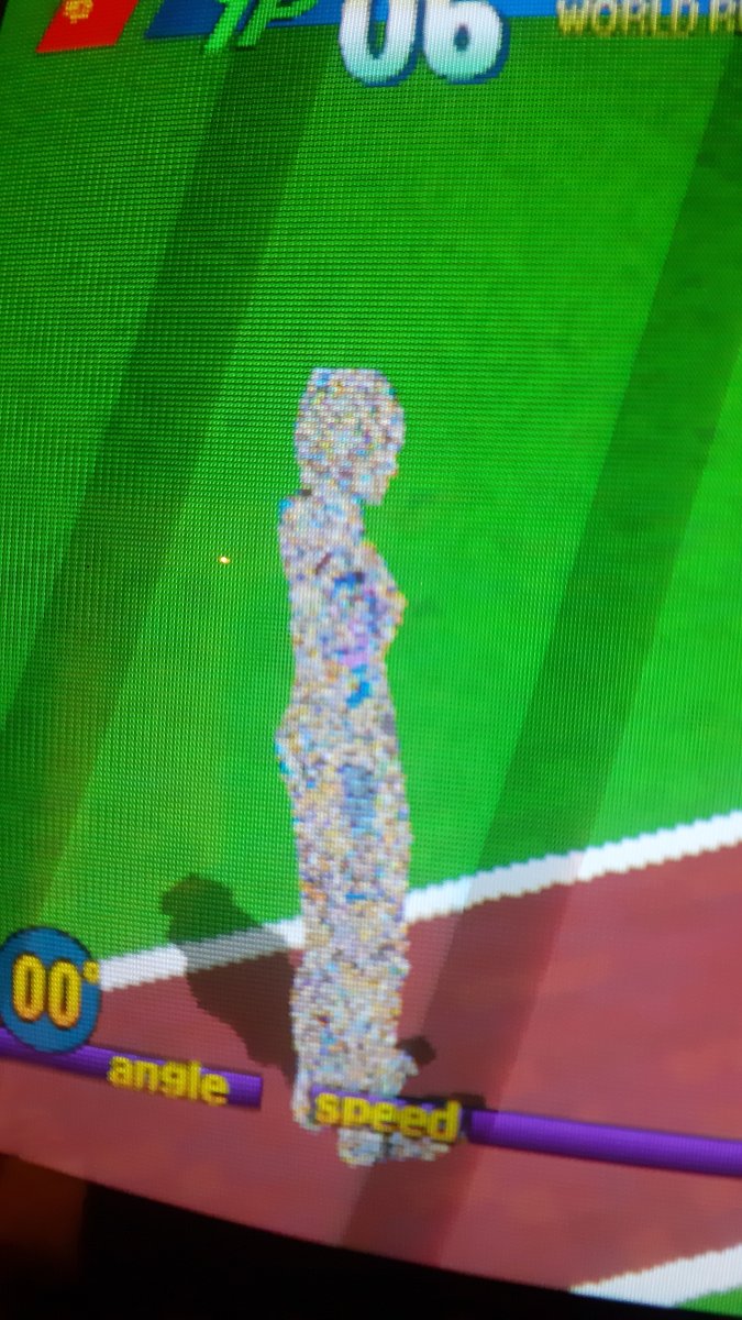

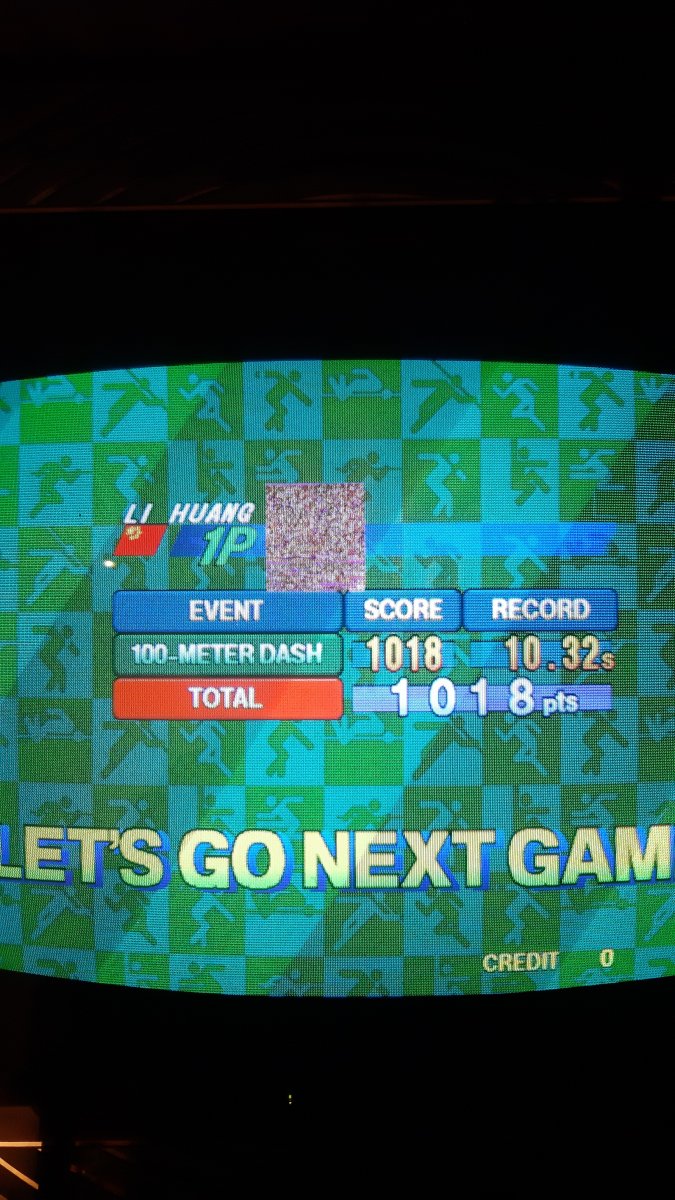

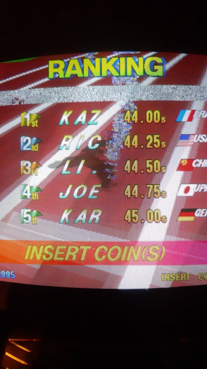

Actually the scambled character is female, I can see two ponytails, one on every side of her head.
Also the same things happen on every region.
Loading up the other set in a bit, but Im positive its the same on the other set.
Ahaaa got it.... its the chinese girl, sometimes she is scrambled, but not all the time😀
That was during play

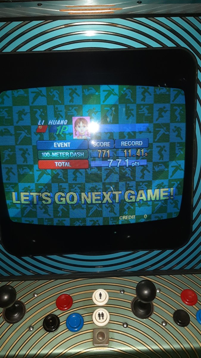

When I win the first event, she gets scrambled
Only when I win the first, it happens..on both euro and usa regions. Jap I just cant win...🤨
When I loose the match, but qualify for the next event, she stays ok

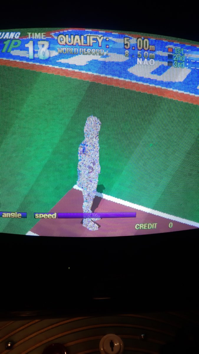

Ok, event names are sorted👍
The girl is still garbled after the first match, but now every time, dont matter if I win or not.
Her portrait is ok now.

which BIOS region it was ?
please, include current region info in each report
