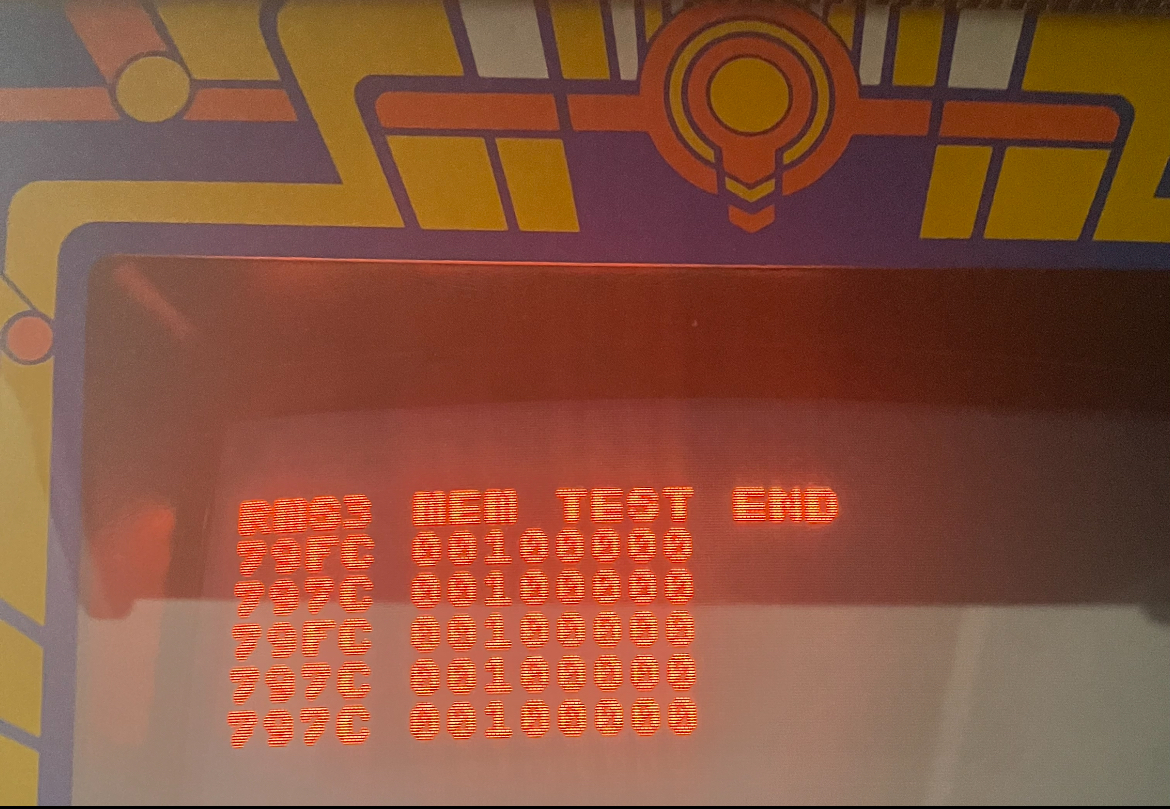

No clue what this means. Can’t find anything about 79fc in any manual.
As I expected, you have a ram failure. Since I am comfortable with desoldering etc I just desoldered, socketed and replaced all the ram and problem resolved.
I dont think I could find anything that listed which RAM was tied to which address / location, but now that I have mine all working, I guess I could remove one at a time to force a failure to give you an idea, but if it were me, I would socket and replace all the ram or test our of circuit to see which of them has failed and replace.
If you have no errors on the test tape, the RAM test page with not have anything listed like you do above. It will be clear screen like the other tests before that one.
Hope this helps.

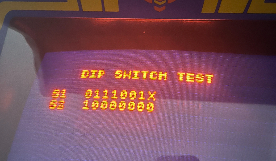

Dip switches also listed some stuff
I think this one is normal, it is just telling you which switches are open (0) or closed (1), #8 on S1 being an X may be not used or a problem, I will try to check one of my stacks one night this week and report back, but I would focus on the ram issue first that should make your game problems go away.

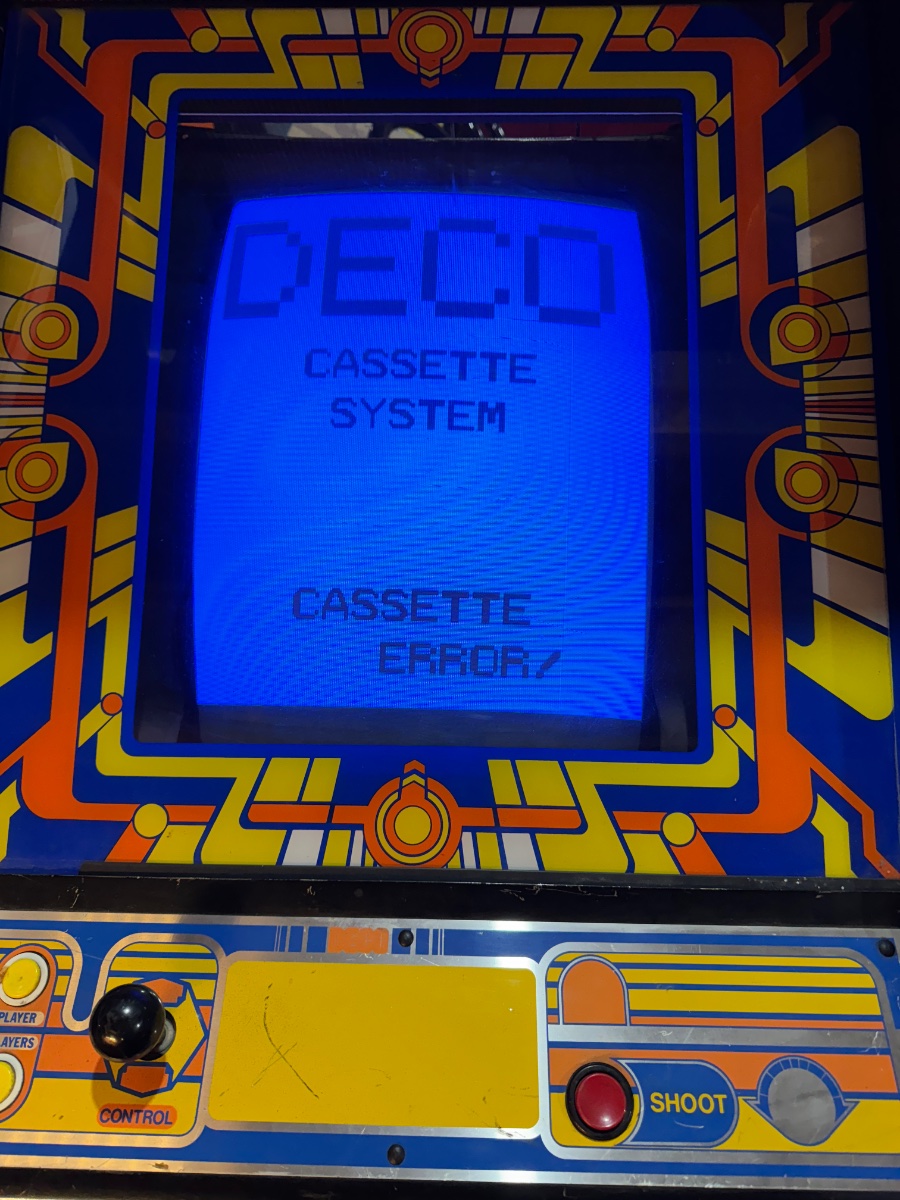

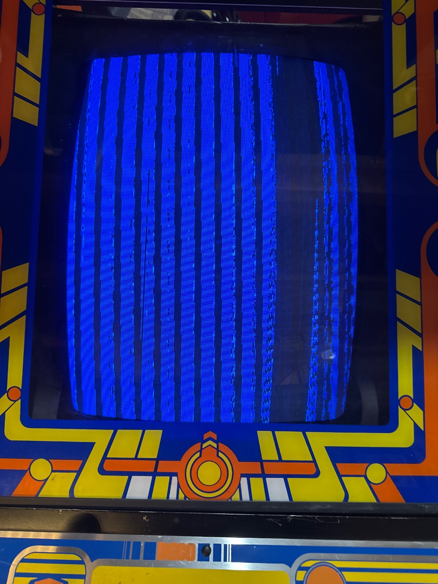

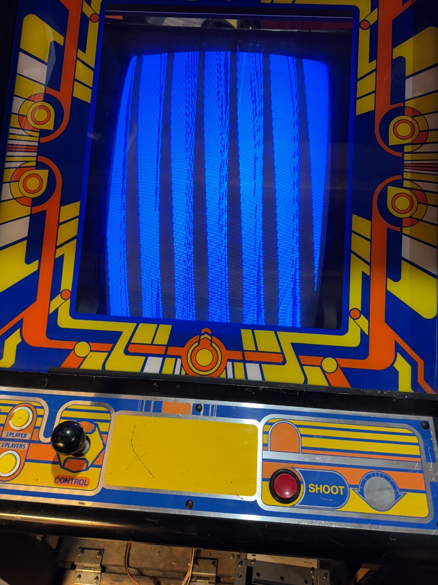

Hello guys, thought I’d post in this thread for some help. I recently got the DS Deco kit, installed per instruction from this thread and ended up w garbage on the screen, 1st pic. Prior to the DS kit, booting from tape/board/ s dongle I would get the cassette error message w no error code, 2nd pic. Different tape/ dongles I would get the garbage in the 3rd pic. Any help thoughts or suggestions would be much appreciated. Cheers

That looks like your horizontal hold is off. Have you recapped the monitor at all?
No I haven’t but the cab had a jamma running Heli Tiger and the monitor was really nice. But, I didn’t try any ahold adj just because it had a nice picture. Should I try that?
