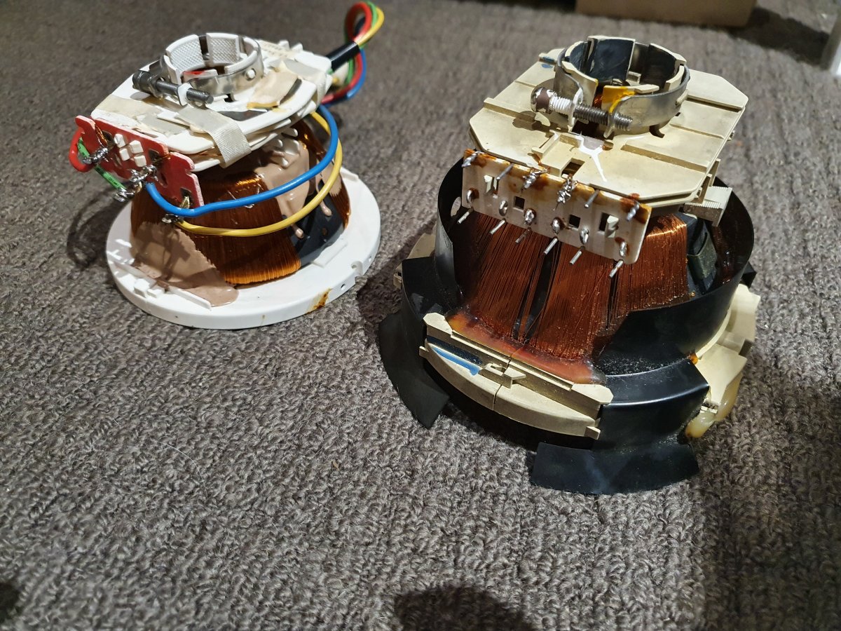

The rubber wedges went bad in my 1084S-P (same as CM8833 ((not CM8833-II or 1084S-P1)), and corroded the yoke beyond repair.

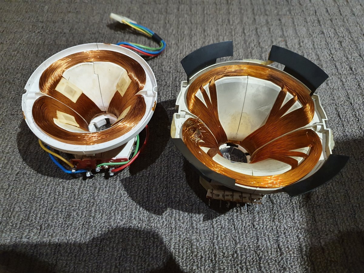

I don't have the readings for a working CM8833 yoke, but I do for a CM8833-II yoke which is similar but not exact compared to a CM8833.
Samsung yoke
4 windings in parallel (two pairs)
each of the four wires are 8.6 Ω, 2.5 mH
each pair is 4.3 Ω, 2.5 mH
total H yoke is 2.15 Ω, 1.9 mH
V yoke is 13.9 Ω, 23.3 mH
Philips yoke (CM8833-II / 1084S-P1)
5 or 6 windings in parallel (didn't take apart)
total H yoke is 2.4 Ω, 1.9 mH
V yoke is 12.3 Ω, 27.3 mH

I don't have the Samsung tube, but yes the Samsung yoke fits the Philips tube snug.
I have a choice of the original rings and the Samsung rings.
