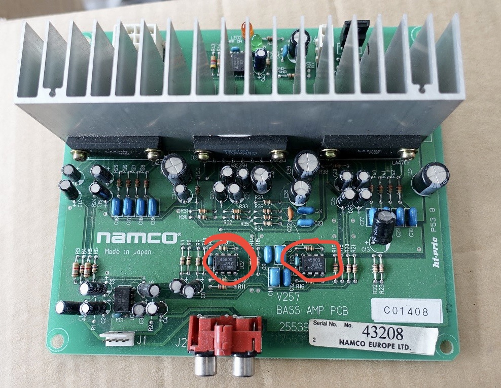

It could probably be an issue with the amplifier ICs. It could have gone bad. Too much volume can also cause some distortion. If you’re able to find the amp, check if the amp ICs get hot, if they do get scorching hot, that means that they have gone bad. The op-amp could also be an issue.

Yep, the op-amp (operational amplifier) is usually used in a variety of audio circuits. For example, one of the most common issues a Mortal Kombat 2 sound board has is a bad op-amp, which can cause the exact same issues you are describing. A bad amp IC will either cause a terrible screeching noise or is dead silent. A bad op-amp can cause distortion/ scratchy audio. I’m not sure what audio amp your cab has but the op-amps on this Namco audio amp can be found here circled in red. Namco usually uses the exact same op-amp IC (SMD or THT) on separate audio amp models they have made over the years.
They used 3 op-amp ICs on this amp model.

ok well my amp is different to that one , doesnt have the phono sockets , and comes from another board in the bottom of cab that has the i/o VGA and sound connected into it, thats why i queried where my amp was
