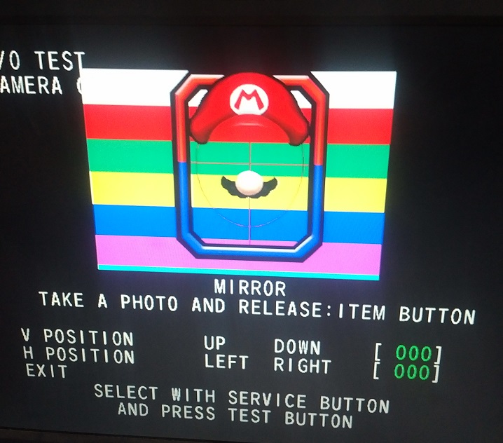

I agree : this static image should be for web preview only. The fact that it's blank is probably bad news for the cam itself.network: Connecting http://192.168.29.100/img.jpg with proxy=DIRECT
It could be that since the camera is broken, it's not generating a usable jpeg for this stream and maybe this would be working otherwise.
Edit: I can also load 192.168.29.100/img.jpg in my browser, but it's just blank. Perhaps this is the URL for a single still generated at the time the page is loaded?
