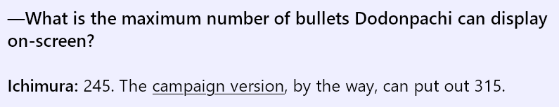

ZBL-NAI did an interview with the ddp devs in 1998, and to save you a click they talk about bullet count...
This is nightmare fuel for a project like this. Why? Remapping RAM is awful without source code, and adding bullets would require remapping it. It's so bad I was not even going to deliver this feature originally.

So my version, also has 315 bullets.

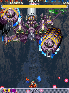

Here's boss 1, loop 2, trying to do his spin move.
Left is 245 bullets, Right is 315.
Without the extra bullet space, he actually doesn't fire the whole way around. See the sad little gap on each side? Pay attention to the turrets right at the end of their spin, when they slow down. They should be firing until they completely stop spinning. On the left, they don't. Can't have that; this is bullet hell! On the right (with 315 bullets!) they keep firing like they should.

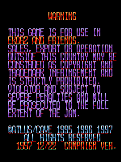

Add Yourself to the Legal Screen: They personalized the PCB for ZBL-NAI when he won the original Saturn Scoring Competition (a.k.a. the Campaign). But this one's not for him, it's for you. Make it your own! Changes save directly to NVRAM, so they'll stay in this configuration even when you turn the game off. YEAH!!!!

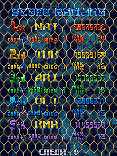

OLI in High Scores: Ok, I actually do know who scored 4th place even though it's not on that WTN video. So, sorry MRV. Olifante contributed a ton of his notes and research, and provided some great advice in a couple spots especially regarding the boss4 bugfix. So, he earned a spot on the scoreboard. Thanks again OLI! (As a side note, I'm becoming a little bit nervous about seeing this up on ebay/yaj trying to be passed off as original. So you can't change this, and it'll serve as one easy way to tell mine apart from the original. Also, there's another way to tell mine from the original too, but I'll keep that to myself for now. Honestly if ZBL-NAI isn't the seller, it's not the real deal. Seriously. And tell your friends this is happening so they know about it!)
This is somehow the most minor and yet coolest part of the whole thing. What a brilliant little hack.

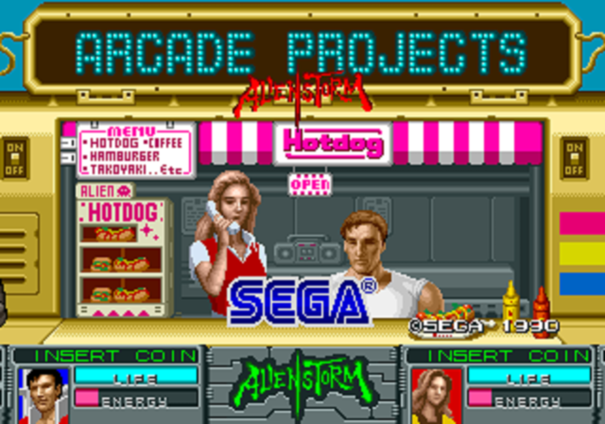

So cool, reminds me of the street food truck name in Alien Storm.
