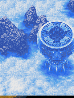

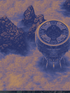

First up, new palettes and background tiles.

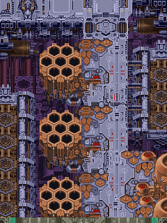

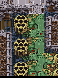

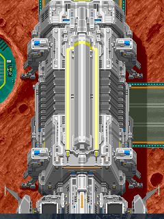

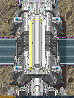

Obviously the title screen has its distinctive Blue vs Red, but they tweaked plenty more. Every level has a whole new tile palette, and a couple even have background tiles adjusted (off the top of my head, stage 2 shown below, and an extended platform at the end of level 4).
Here's a couple side-by-side to help illustrate the changes.
Original is on the left, in case it's been a while for you!

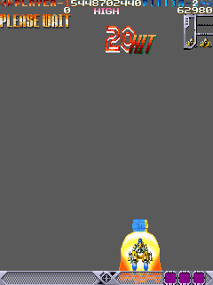

The Stage-Over screen got a rework, and it's not just palette change. In the original it will count out all your winnings slowly, or if you press a button it will skip the math and animate things 'fast'. In the new version, it really hustles through it all even more quickly. This is a comparison between the 'fast' versions on both. They also added some background flash, and lengthened the Boss Hit Bonus box.

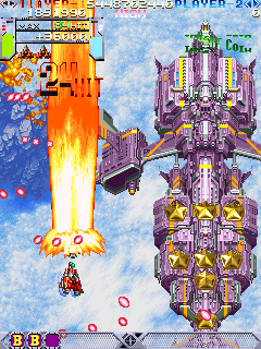

Oh and if anyone actually wants to help on this project, there's one thing I just can't figure out -- and maybe you can.
Watch the video and tell me what you think is driving the color change on the MAXIMUM bar. Watch it for a couple minutes. Other sections of the video have it, too. It clearly turns blue (for the first time) when Hyper is engaged, and speeds up, but beyond that it starts flashing like mad a little bit after that and just randomly switches between red and blue. If there's a reason to it, I want to implement it, but I can't think of anything driving its behavior. Not enemy kills, chain increases, reward pickups... nothing lines up to me.
Maybe some other cave titles have similar effects and folks know what's driving them?
