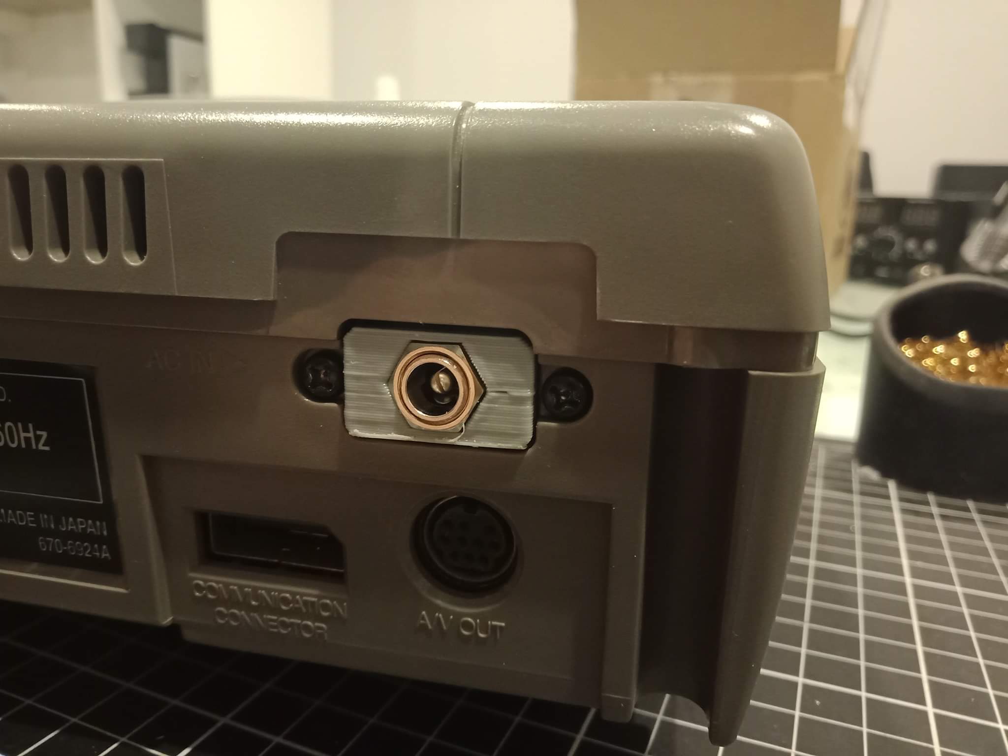

This DC power jack support is much better.
https://www.thingiverse.com/thing:3208337
Sits flush, hex nut of DC barrel is inset, can use original screws to mount with no other hardware necessary.
Don't mind the rough print. Low settings for quick test print and my printer is crap.
Agreed, that one looks much better! We printed the files from the saturnpsu github, must be a bad file rather than wrong print..
yeah looks like the design posted with the PCB files is not 100% accurate, but looks like you found a good alternative :)

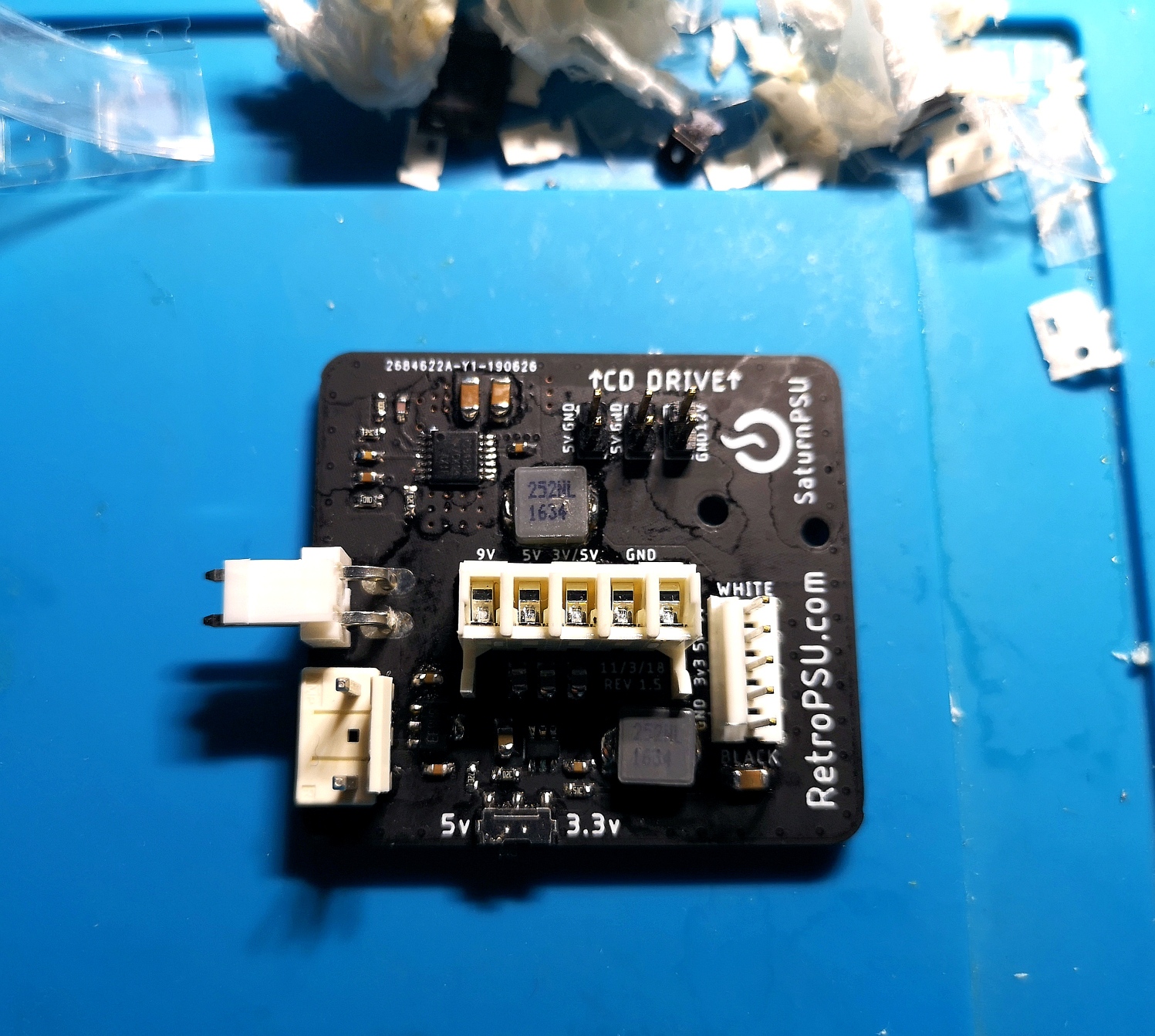

So... I can't get this working.
Yes, it powers on the console but it won't load a game, seems as if it's short on power / current.
Power on console, run through splash screen etc fine.
Open CD door, fine.
Close CD door, console freezes. Do this with a game disc inserted and it spins the disc but freezes. I can see the green power LED dim when trying to read a disc, stock PSU doesn't exhibit this behaviour.
Return stock PSU and all is well.
All voltages check out both out of circuit and installed into the console / under load. A bit lower than a stock PSU but nothing worth noting. Under load the 9V line does dip to 8.9V when the CD door switch is triggered.
I initially tried a 12V / 2 Amp power pack, from an external hard drive. No dice. This same PSU successfully runs a Pico ATX and arcade boards so I thought it would be fine.
Beefed it up by rigging it up to an arcade PSU that outputs 12V / 2.5 Amp, still no dice.
Tried with all 3 x PCBs that I assembled.
Japanese grey model 1 Saturn.
Anyone here actually have a SaturnPSU working? Trying to determine where the issue is. Have I done something wrong, missed an installation step, or is his latest design which differs from the working prototypes I've seen flawed?
Tried a 3 amp / 12V mean-well PSU, no dice. Also tried using a stock composite AV cable as opposed to scart, in case the scart cable power draw was causing some form of conflict, no dice.
I'm calling it a day. I can't get this retro PSU to run a mechanical CD drive, it just doesn't seem to have enough power for it. I'm confident it would work fine with an ODE device though.
Stock PSU is going back in and never coming out again.

I've been researching this and here are my thoughts. Just a hunch so don't take this as Gospel however at this stage I'm rather confident there's some serious design flaws with the Saturn retro PSU.
There's variations between Saturn models / stock PSUs, which I won't delve into here as I want to keep it relevant and simple:
Saturn (my version at least) has 5 power pins.
GND
GND
3.3V
5V
9V
The switch on the retro PSU toggles power on that third pin (3.3V in my list above) between either 3.3V or 5V. Some Saturn's have no 3.3V and two 5V rails, my particular Saturn console has one 3.3V and one 5V rail. So the switch ensures compatibility between hardware variations. It's wired as the middle pin as output, left pin 3.3V supply, right pin 5V supply, so pending on switch position one of those voltages gets sent through.
PROBLEM 1: The switch is only rated for 0.1 amps.
9V is used by the CD drive on my revision of Saturn. Later models ditched the 9V and just use 5V.
Not to complicate things, but some Saturn's do use 9V for scart but that doesn't apply here.
My hunch is the retro PSU designer neglected to account for Saturn's that utilise 9V for the CD drive, thus not enough current is available. Plenty on the 5V line, which is what the later rev Saturn's use, but this doesn't help people with earlier Saturn's that require more amps on the 9V line to drive the CD.
PROBLEM 2: The 9V regulator of the retro Saturn PSU is only rated for 0.15 amps maximim (with heat sinking).
Another thing worth noting, both the switch and the voltage regulator of the prototype version, shown working in promotional videos, differ greatly to the final released design. They definitely look more robust on the prototype. Coincidence or meaningful?
I'm thinking along the lines of him changing the design at the final stages for whatever reason (parts cost / availability / compactness etc) and never fully testing it due to the nature of what happened with things going south.
It may still work with ODE devices or later model Saturn's that don't use the 9V at all or as heavily, but as it stands if my assumptions are correct it's not going to work with earlier hardware revisions.

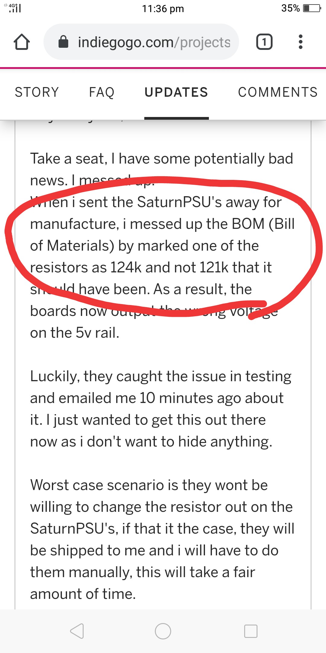

If you read through the indigogo updates, Chris mentions problems with a particular chip and the boards not passing testing / having intermittent issues etc. Working fine sometimes but perhaps failing 2 or 3 times out of 10.
He also writes:
Yet on the released design that resistor, R10, is still listed as 124K and not 121K which he says is the correct value.
I don't think these ever worked properly. Not rubbishing Chris, I'm sure he's a great guy and I wish him the best, it's not personal but I'd be weary of building these or installing them into a console. At least not until he responds with some clarification or information.

Not good the wrong BOM was uploaded...
