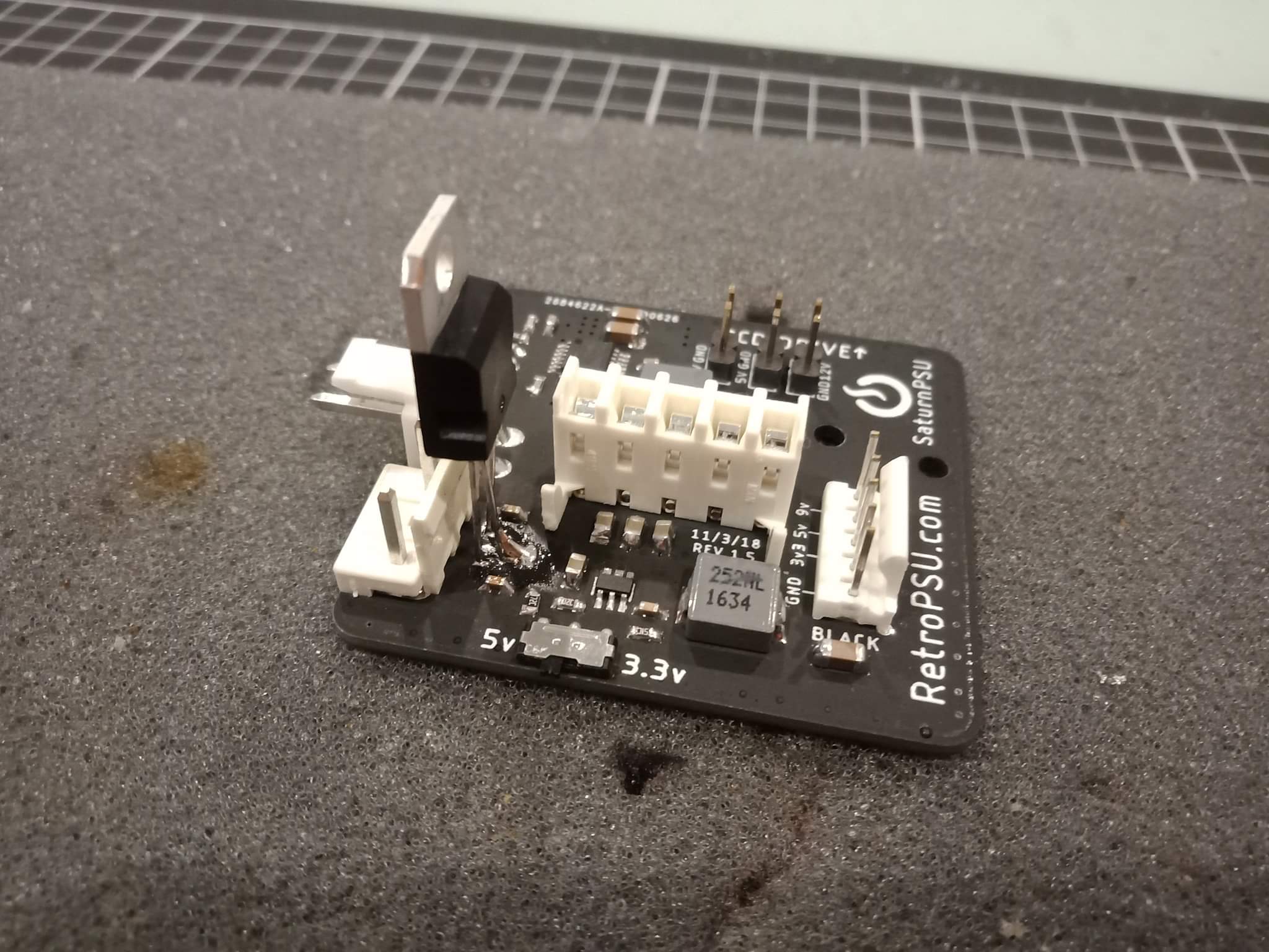

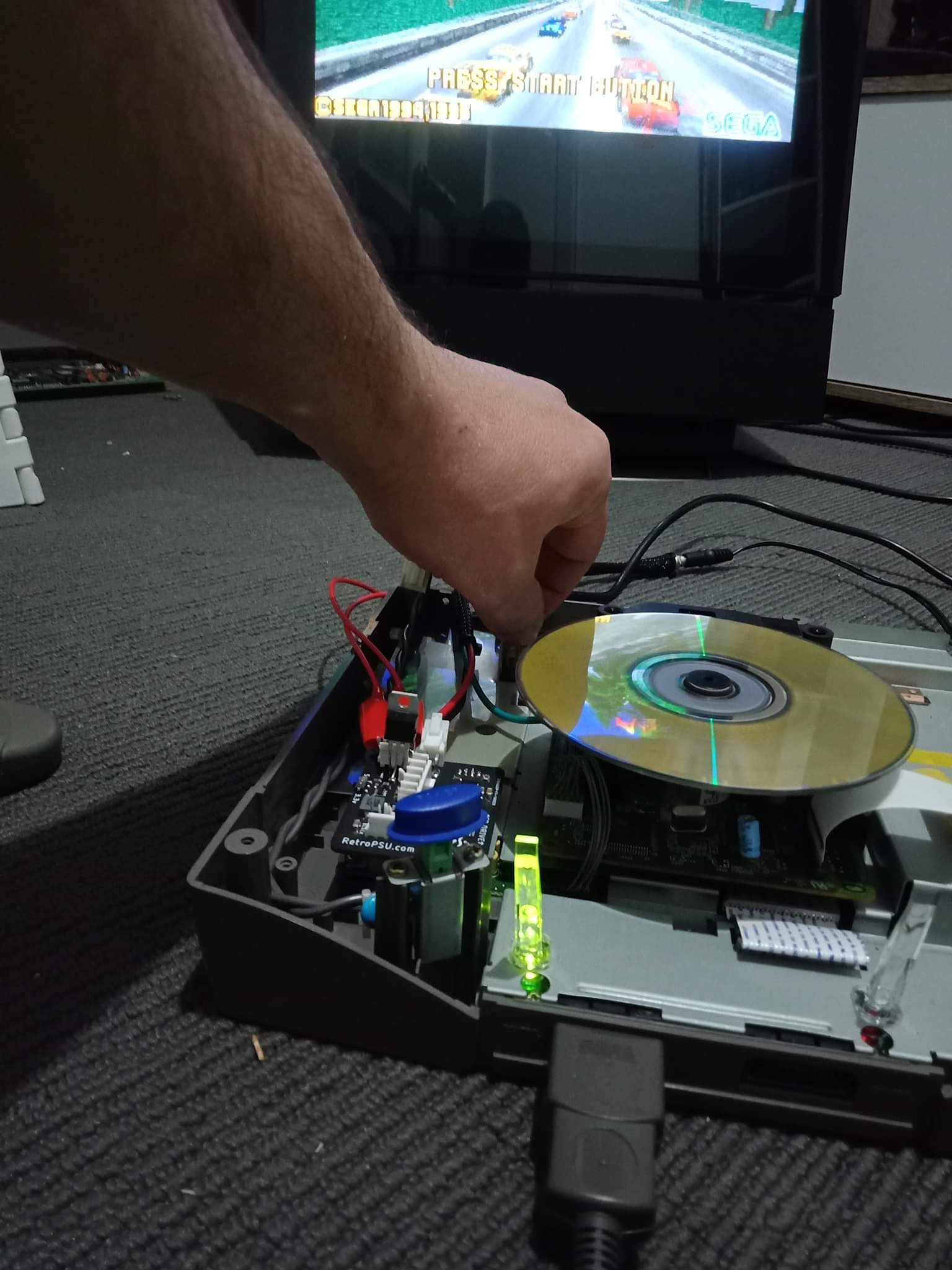

Suspicions confirmed.
Installed a 1 amp voltage regulator and it works fine.
Forgive the Frankenstein approach, it wasn't easy shoehorning in a through hole regulator on tiny smd pads.
I'm really pissed off. Who the hell uses a 0.1 amp regulator to power a CD drive!? I won't publicly rant, so that's all you'll hear from me on the subject.
I will say - DO NOT USE THIS PRODUCT.
Two things need to happen to the PCB design, a higher rated 9V voltage regulator and replace the switch with a better one or just use jumper shunts.
It will work as is in Type C and D power supplied consoles, but not in Type A or B.
Someone needs to put the word out. @RetroRGB @SmokeMonster
These retro Saturn PSUs are flawed.

Great you had a 1A regulator in stock to test it!
So if someone would replace the existing 0.1A component with a suitabel 1.0A SMD component (if even available in this small footprint..., TO-261-4 or TO-263-4 package perhaps?), could this cause any damage you think? Other components or traces that are too limited and might be overheating during use?
