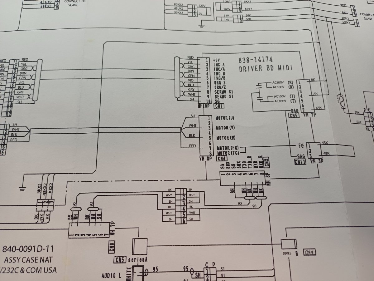

  • I have compared the schematics from both Initial D3 and Outrun 2.

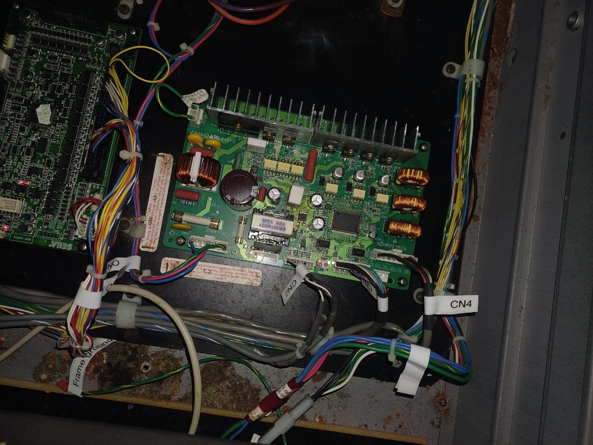

  • The driver board is the same model. The connection is going from CN6 on the Chihiro fitler board to CN2 on the driver board.
  • CN1, CN4, CN5 and CN11 are all wired correctly.

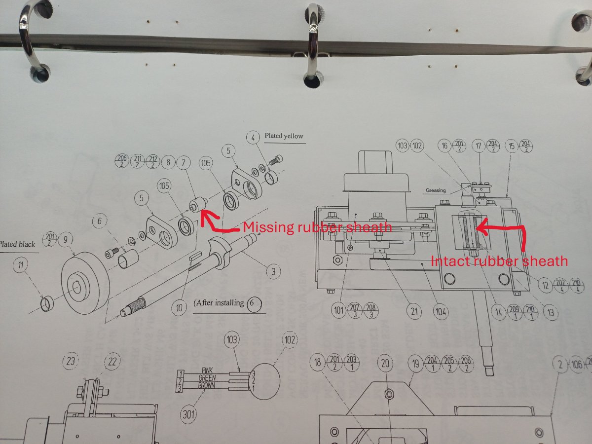

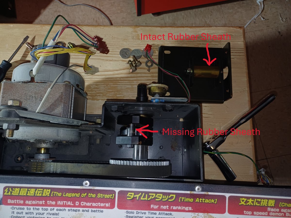

  • I pulled the stopper cover off the steering mechanism. The stopper rubber on the top is actually in excellent shape (part number TOF-2512), but the stopper rubber along the drive shaft is gone (part number TOF-2509X). I am looking for a replacement, but I doubt I will find it. If anyone has a suggestion for a replacement, that would be great. Ultimately I don't think this is an issue.

I actually bought a reproduction of that part on eBay here
I replaced both 2509 and 2512 and they’re working great
I also took Ken’s advice for heater hose. It installed fine but didn’t hold up as long as I would have liked. I guess I haven’t checked the eBay bumpers but they felt really nice when I got them. Just expensive
