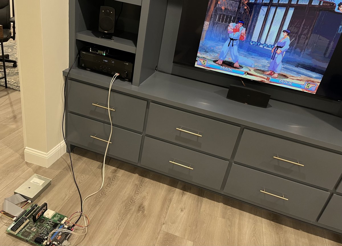

I can successfully write anything with my UltraBIOS + ISO when it’s in my working drive, so I know it’s not the drive or cables as the drive gets plenty of power. Here’s my setup on now in front of me with 3S loaded:
First time in my years of dealing with CPS3 I’ve seen this cart not reading CD mismatch!
