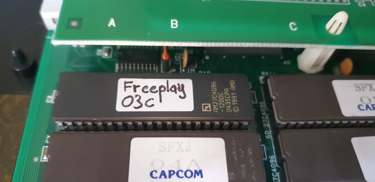

I managed to finagle my way through a hex editor. Got Free Play and Random Stages working ON REAL HARDWARE.
Try for yourself below. I've only included Roms 3 and 4 as they're the only ones modified.
This works well for me in 2 player but the single player game has a few issues.
In single player the first character fought against seems to be random but all of the subsequent opponents are Ryu. Also when you lose a match the game drops to black and requires a reset.

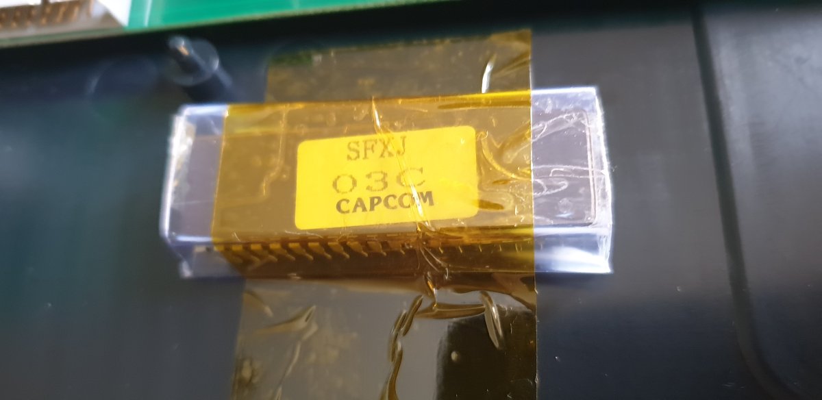

I just burned a Hack Eprom 04.
I did the same test on an SSF2X with an Infinity Key & an SSF2X under battery X/
The Hack Freeplay does not work & the game at startup remains black screen 8|
Where can I find the Freeplay 04 Hack Rom for Battery & Infinity Key Version ?
On the other hand, if I put the Phoenix Edition version with the Hack Freeplay on a motherboard & I remove it, I replace it with an infinity key or Battery version that keeps the freeplay of the game and without crashes.
