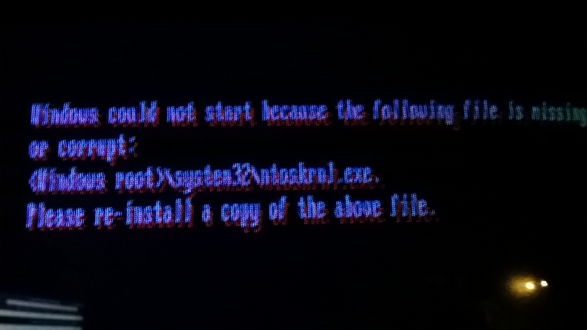

Crashed, now I get this. *sigh*
Anyone care to test my Daemon Bride cart on their ex-board?
