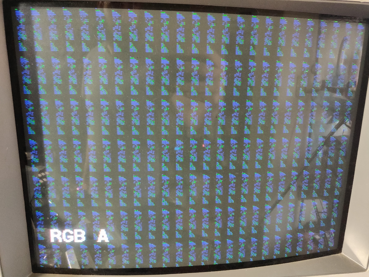

Time for round 2. This B board was one of 3 that I acquired from another forum member a few days ago. It didn't have the kind of severe pin damage on the customs that the first one did, but it was definitely in need of some work.
My first course of action on this one was to clean the corrosion off of the DL-1927, PAL 10H, and all of the LS245s near CN1 and CN2. To do this I have started using a dremel with a wire brush attachment. It is really good at removing corrosion, but is still gentile enough that with light pressure I am not damaging any legs or pads. Once the corrosion was removed and the legs were inspected, I decided to go ahead and try powering the board up to see what would happen.
Unsurprisingly it had issues, but at least it boots reliably. I began with a close visual inspection of the most corroded areas, which were mostly around the pin31-60 range of the DL-1927.
Several pads were completely missing, but none of the legs were damaged so I went ahead and reflowed them, and repaired the obviously missing pads. After that I tested it again, and unfortunately I forgot to snap a picture of it, but the background layer was covered in $$$ now. It did appear to be generating more graphics correctly though, but the sprites for the characters were super blocky, like they were 1/4 or 1/8th their normal resolution. Poking around the DL-1927 with my oscilloscope, I found that pin 67 (A01-ADDR19) was floating, so I poked around it's trace until I got to a via. The via was dead, no conductivity between the two sides of the board. I repaired the via by running a wire through it and soldering it to the traces on either side of the board, but after that pin 67 was still floating. It turns out that the trace was also broken underneath the DL-1927, so I ran a bodge wire from the pin to a spot further up the trace.
After all of this the background was no longer filled with dollar signs, and was being rendered properly. The sprites for the characters were still super blocky. All of the address and data lines for the graphics roms were showing good activity, so I started looking at the graphics bus. That's when I found that 10 of the graphics bus pins on the DL-1927 were floating. It turns out that almost all of the vias below the DL-1927 were dead, so I went about repairing each one in the way I described earlier. There were also 2 dead vias on the LS245 at position 10L. I repaired all of those and here's what the board looks like now.
Test time!
Total victory!
I have to admit that this one was much easier than the first one. I think I spent a grand total of two hours working on it. Having the knowledge of where to look and understanding which chips are responsible for what helped a lot in pinpointing the problem this time. It also helps that the damage on this one was far less severe.
Now that this one is up and running I can start looking at the -4 board that has been giving me trouble further upthread. Hopefully I can nail that one down and provide a nice detailed writeup for it as well.

This board is the one I was talking about in post #24. As a preamble, I did some work to this board before I posted about it earlier, so let me explain what has been done so far. The most obvious damage was to the LS245s at 10L and 10M. The input side of both were corroded beyond salvageability. The pads and legs were completely gone, so I pulled good LS245s from a donor board and replaced them. Since half of the pads were gone, I had to run new traces for all of the missing pads. I had also found a few broken traces on the graphics bus at DL-1927 and ran new traces to repair them. That's about all I had done at the time.
When last we left off this board was booting occasionally with garbled graphics, but most of the time it simply boots to a garbage screen with no audio. When I'm struggling to pinpoint the source of an intermittent problem my instinct is to apply pressure to various components and see if I can cause any changes to the behavior of the board. I'm basically looking for cold solder joints or other sources of poor conductivity. While pressing on components, I found that If I applied pressure to PAL BGSB2 while the board is booting it would boot successfully every time. On this board all 3 of the PALs were socketed, and the socket for PAL BGSB2 was disgusting. I decided to remove the sockets for PAL BGSB1 and BGSB2 and solder the PALs directly to the PCB. Most of the B boards I have worked with do not have these socketed anyway. After soldering these two PALs in place the board boots every single damn time. Excellent, the biggest mystery is solved. Now this is what I get.
So the first graphics issue I tried to solve was the missing and messed up background layer. Obviously some of the maskroms data were missing entirely, so I checked the CE lines on all of the roms and found that CE for roms 14 and 16 was floating. I tracked the problem back to dead vias for GFX-A23,A22 and A21 at the DL-1927. That solved the missing graphics that you can see above, but the background layer was still garbage. I found that pin 67 on the DL-1927 was floating which connects to pin A9 on the CN2 connector and is part of the graphics addresses coming from the A board to the DL-1927. This issue was caused be a dead via, which I repaired. This improved the background situation, but it still looked like there was some sort of layer priority issue going on. I probed around some more and found that pin 65 on the DL-1927 was also floating. This one is interesting because it's supposed to be connected directly to ground, but it's actually an address pin. I patched a wire over to a nearby ground pin and the background now looked perfect. The remaining issue was with sprites. This is what it looked like.
Poking around on the LS245s at position 10L and 10M I found that I missed a couple of broken traces going to CN2 when I replaced the LS245s due to severe corrosion and leg damage. I was distracted by the damage on the input side, and I completely forgot to check that the output pins of the LS245s were connected to CN2. Well it turns out that I had 3 broken traces between the LS245s and CN2. Now the sprite issues are gone! THIS BOARD IS FIXED!
