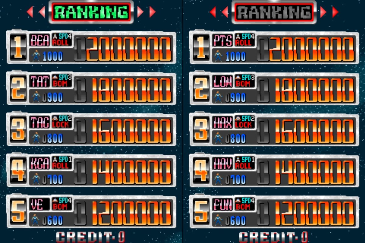

Here is screenshot of the affected highscore table. On the left is unmodified and on the right with this change

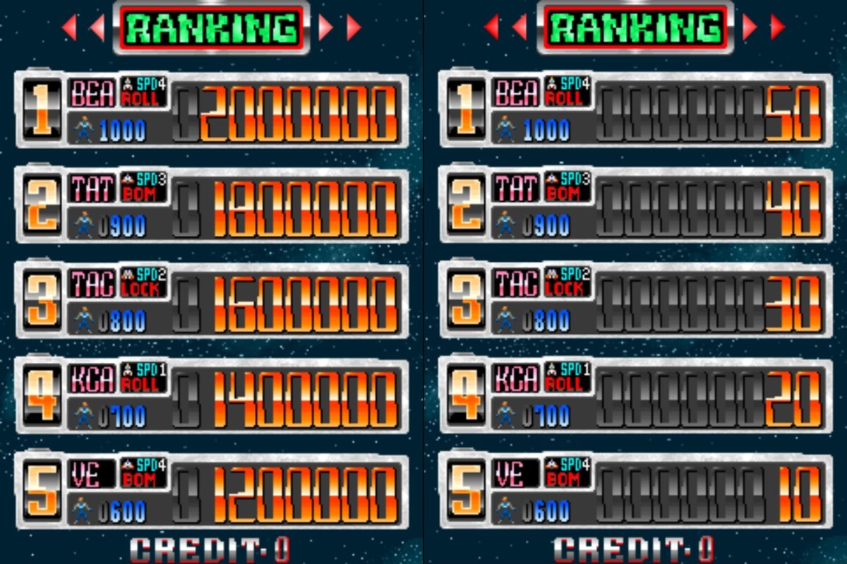

One thing from the score change that I also wanted to try and change was the initials. For this I first tried to find them as ASCII strings but no such luck. After some searching stumbled on a good tutorial on YouTube
View: https://www.youtube.com/watch?v=4JFO_MEPHsE
The short of it is that the alphabet values do not always correspond to the ASCII values but the value difference between the letters should still be same. So 'B' will always be +1 what ever 'A' is. The video creator had also created a python script that can try and search all permutation of said string of letters and return their memory address. Problem with searching short string like 3 letter initials is that they can give a lot of results from a single rom. Decided to try out all 5 initials. Some returned close to 100 results but luckily one had only around 5 results on ROM 33 and other and had a similar number of hits on ROM 34 so could focus on trying to change those and after a few attempts found the initials data.

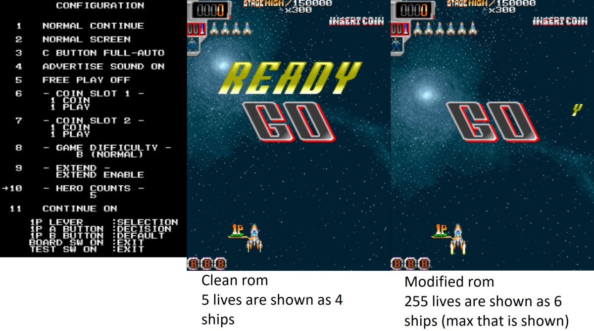

After these was wondering what else could I pattern search that would actually affect the gameplay. Decided to go into settings and there you can change the 'Hero counts' (lives) where the default setting is 3 and after that when clicking 'A' you change it to 5, 2, 1 and finally back to 3. Found one match when searching a pattern of '03 05 02 01' and these are the lives count you get for each setting. So by changing the '05' to 'FF' and when choosing the 5 lives options from the in-game settings you will actually get 255 lives when starting the game. If you leave the rest of the values alone they will function as normal so you can opt-in for almost endless amount of lives if your tired of feeding credits and want to just practice :). Only downside I noticed that you seem to get points for each extra live after the game so prepare wait a while it to finish and go over the 9 999 999 max score a few times.

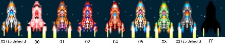

Finally tried to also change the initial bomb count, but there was no setting for this in-game and there was no other number that I could figure out yet so that I could search a bigger pattern from the code. So I tried to brute force by changing a bunch of '03' values from the ROMs and the verifying what had changed. There are a lot of '03' in the two ROM files and I didn't have the patience to go through all of them. Did stumble on a lot of GFX glitchings, broken stuff, game crashes etc. But I did find maybe one useful change that might interest some that you can change the player ship colors. The P1 ship color default value is 03 and it can be changed to anything between 00 and FF so a lot of different values to try out. I think at least some of them are color schemes from enemies or other GFX from the game for example 'A0' was pulsating red. I compiled a few example for the preview image.
