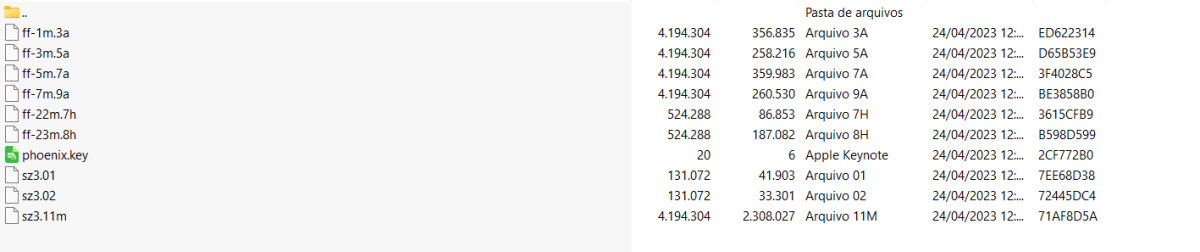

Hi! If I wanted to use this in real hardware (I have a spare rev 7 b board), what do I have to do with the phoenix.key archive? is it meant to be burned into a GAL or something?Thanks dude! At first I did everything by myself and got a blackscreen after the ROM finished loading on my Darksoft Multi. Now everything works
I don't know how it works cause I've never done it but I came across something about programming the key with Arduino. it runs to the same header where you would solder the Infinikey underneath. (permitting of course you have one, they're apparently unobtanium now). I think that's what the separate add-on harness for the key programmer is for with Darksoft.Hi! If I wanted to use this in real hardware (I have a spare rev 7 b board), what do I have to do with the phoenix.key archive? is it meant to be burned into a GAL or something?
Hi there, how can I run this on real cps2? Got the files from results folder but I don't know rom placement on the board. THX
