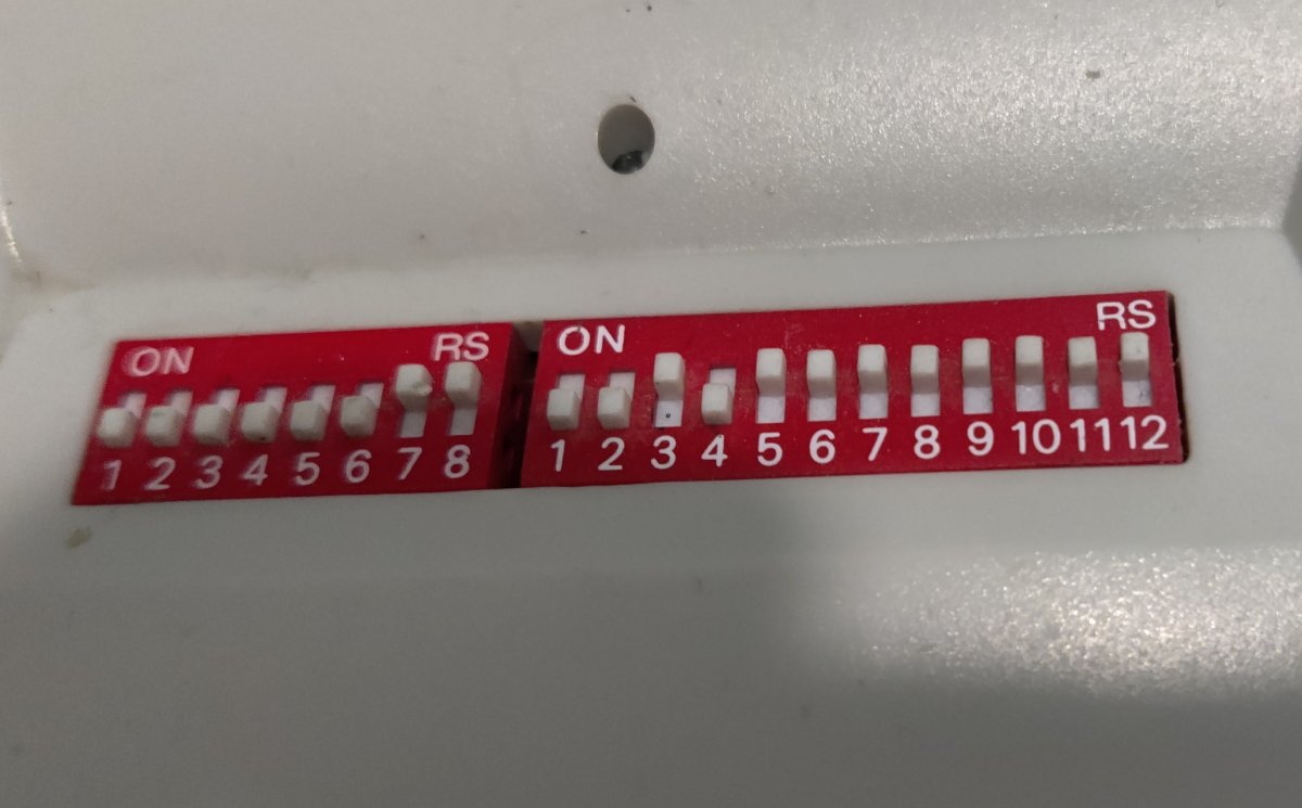

I can say the cost, ease of setup, and ease of use for MGCD is definitely the most appealing part of the whole process. The only thing that is kind of annoying is having to reset the dip switches for each game. Is there a way for me to just turn off all dip switch settings and allow the game to just boot up and let me run it like a regular Dreamcast? Also the audio by default is not good coming out of the MGCD. But I was able to bypass that via DCDigital install.
Yes, there is a specific dip setting. This works on disc based games as well, but it works 100% on a GDEmu Dreamcast.
