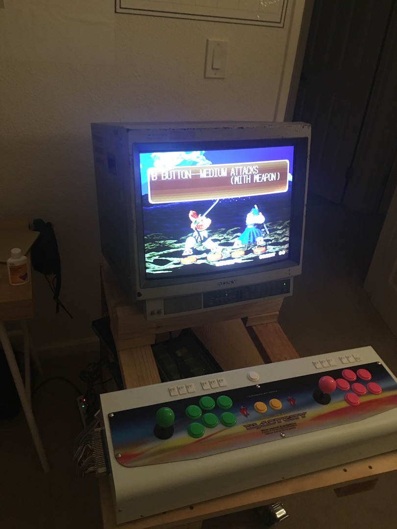

I got my samsho in and was able to test my MVS1FS, the mobo indeed works. So now I am back to wondering if my trace cut was bumb, my card or card preparation was with err, or some other issue.
edit: to be clear I did test cut trace with continuity meter.

If you feel like you need to send it to me for testing then please do so. There will be no charge if it is a n issue with the cart.
