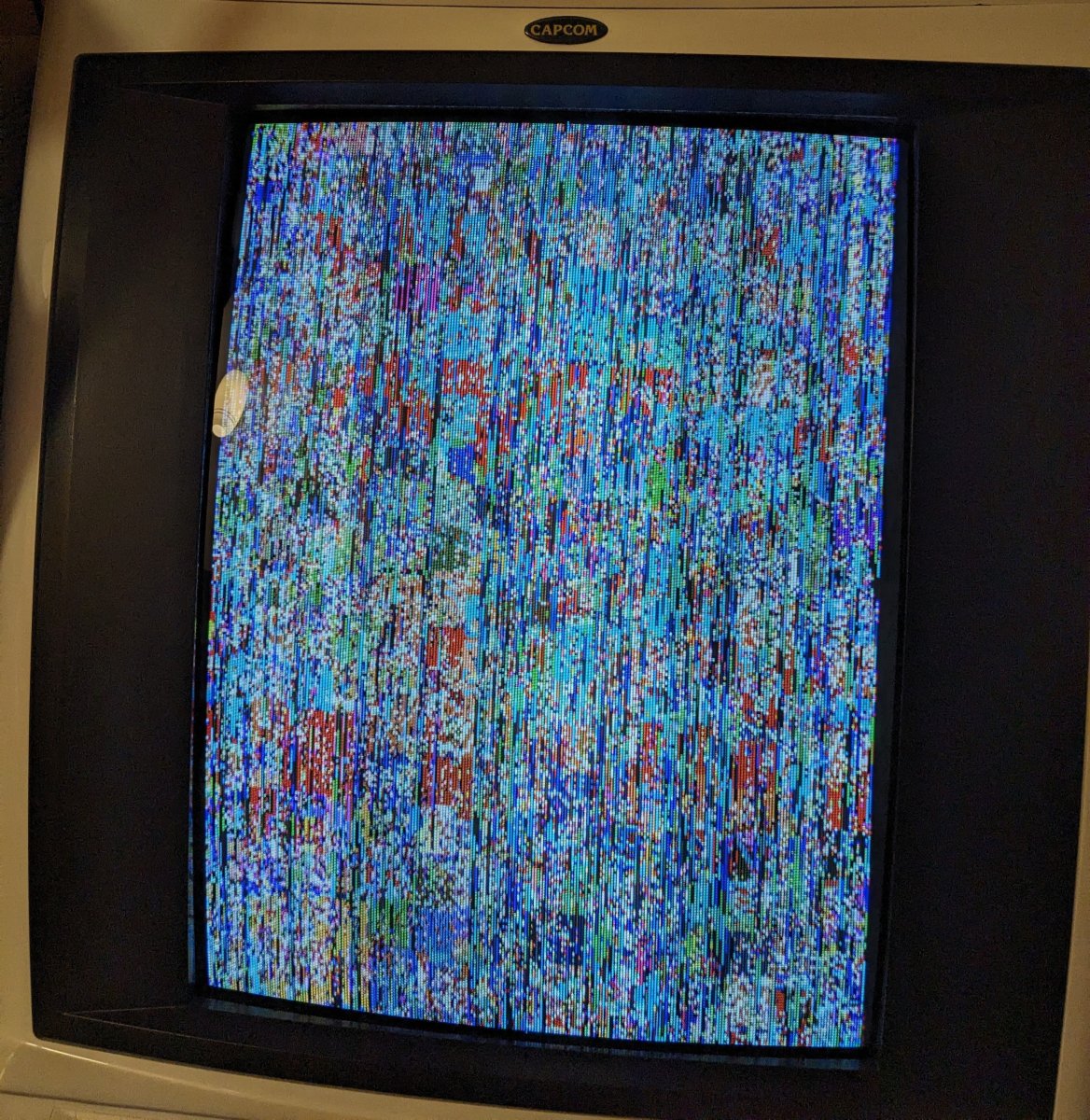

I got a Fixeight PCB off YAJ that was shown as fully working. When I received it, it only boots to garbage or a black screen: That image moves for a bit then freezes. Volume pot gives feedback during this but no sound/credit. Test button does nothing. This is tested on 2 different cabs. I noticed the ceramic custom HK-1000 had a crack but from what I've seen this doesn't stop the game from booting.

Doing that alternates the 2 boot states - rolling garbage to frozen garbage - to solid black screen and vice versa.

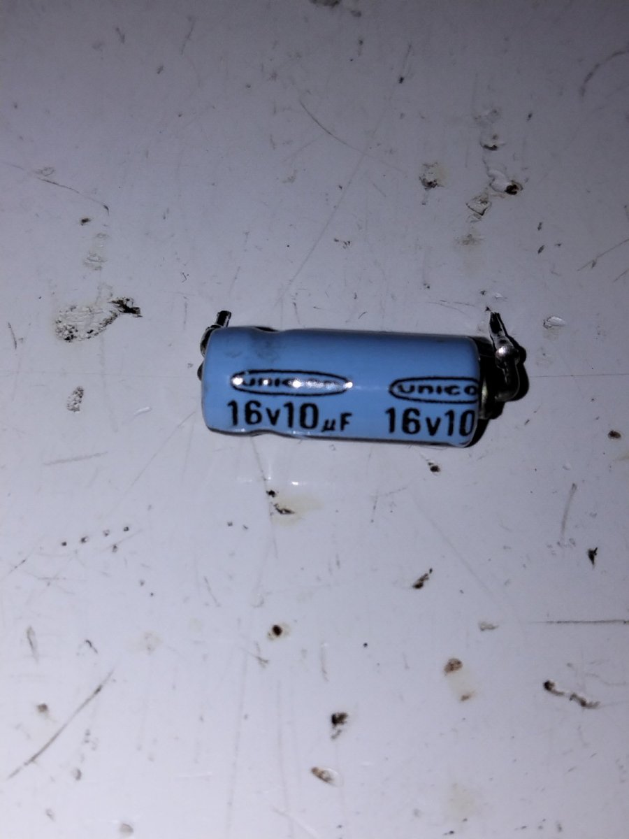

A 10uf 16V axial electrolytic capacitor in the reset circuit was suspected to be the issue. It was slightly out of specs therefore the RESET signal to 68000 main CPU was not stable so it did not reset properly.
Replaced it and tested in his Astro City and now booting every time.
