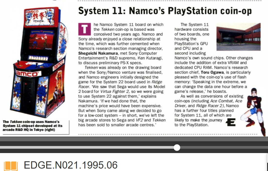

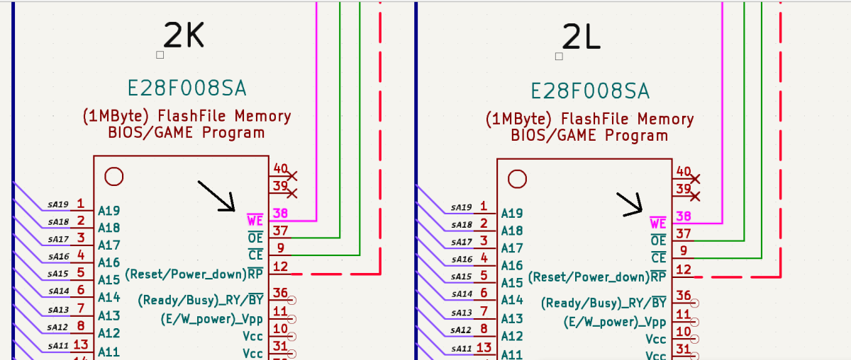

i remember reading in an article that dates back to the launch of namco system 11 (just before the launch of playstation 1) namco was bragging about the ability of loading the game code quickly onto the motherboard and how that would make life easier for them as developpers. it was on archive.org. i even noticed while trying to make a schematic for this system, that there was a R/W signal going to the flash chips where it enables there WE pin on those flashes (why would a game modify its code during play!!). this goes in tandem with what namco mentioned in that interview ! i guess this might what you are looking for...
