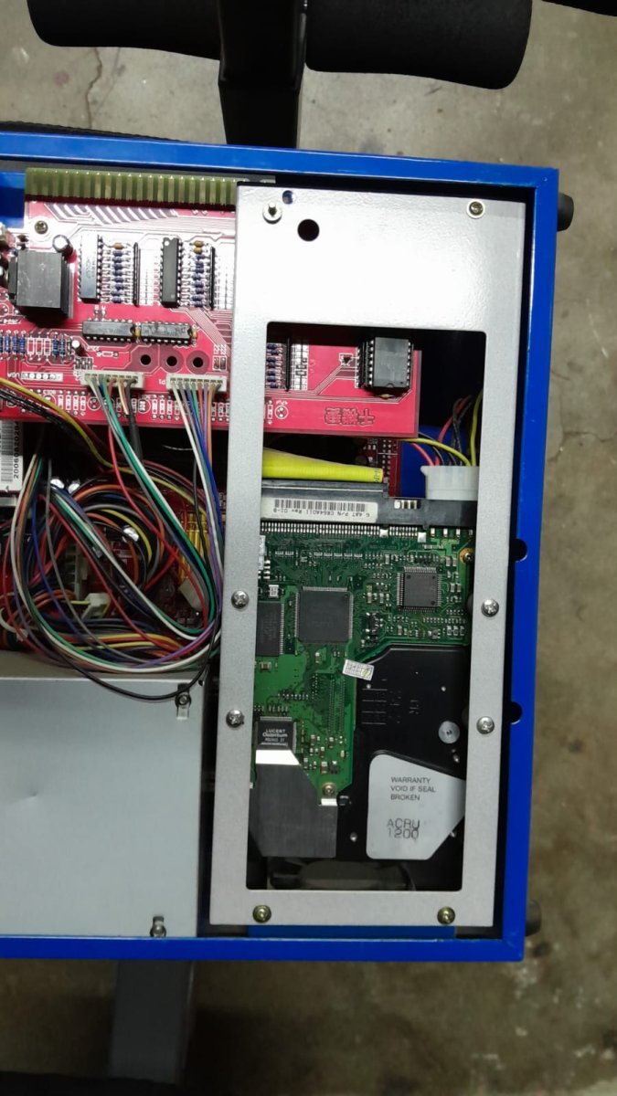

I don't have it nearby, I remember that the MB is a Foxconn, regular microATX. My CPU I think is a Celeron 900MHz. Then it has a GameBox board, as you can see in the first post in this threat, where the JAMMA connector is plugged, with some wiring welded to the PS/2, video and sound ports.
I think this gamebox board has many more possibilities, if only more documentation were available...

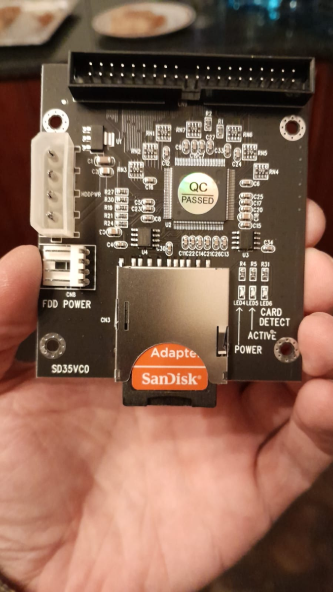

Last step: I had the SD card with some games not working.
Now: SD card stopped working and original HD died (click of death) :/
I redumped the image to the SD. Checked with imgc and iso dumps I posted here. Menu loads but games don't.

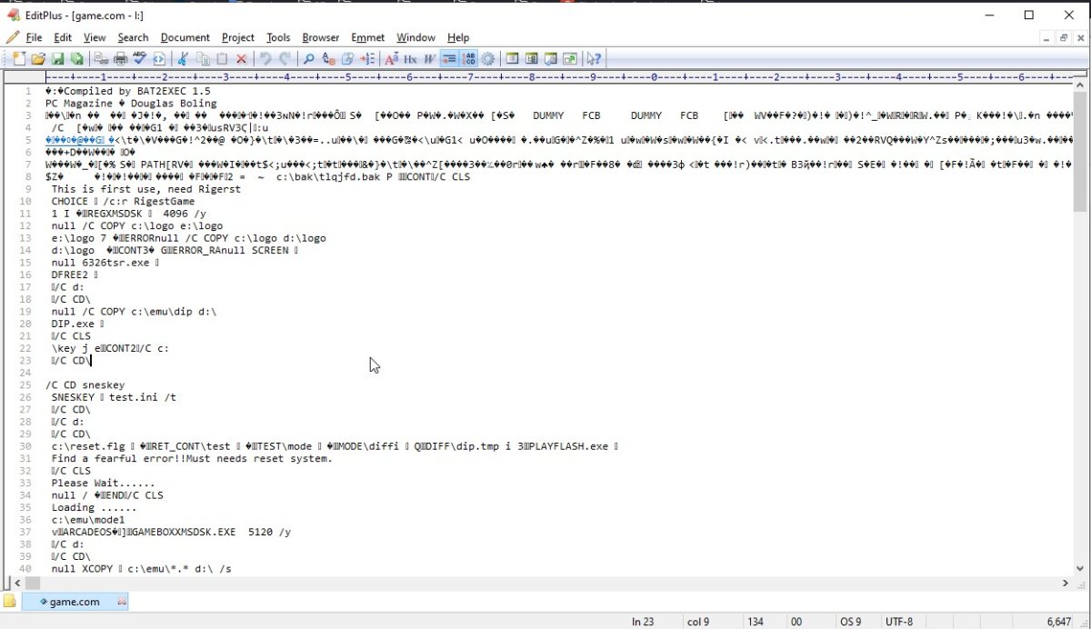

The autoexec.bat file just executes the game.com file at the root dir. I "migrated" to a FreeDOS, but it launches a memory error. That's because memory manager executables in FreeDOS are different than in MS-DOS, so.. Quite extrange, don't you?
I opened game.com file with a text editor, looking for a clue or something. Sometimes you find plain text information that can be usefull.
Et voilá, it's just a converted batch file made with BAT2EXEC 1.5. Now I'm trying to dissasemble the file...
EDIT: It seems that back in 2011 someone found the same.
An initial look to the file, it creates a virtual RAM disk, copies the needed software into this drive, checks the DIP switch settings with \emu\dip.exe...
The thing is it's basically using ArcadeOS and AdvancedMAME, so it's a first step to modify our boxes.
