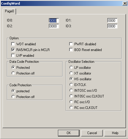

@rtw Can you please post your burn settings, if any are needed, for the binaries you posted.
I will be using a TopMax 2 with its software to try these.
Sure @Derick2k in the all the excitement I kind of forgot about that part :D
Granted I'm not good at this, but I can't seem to get @rtw's code to work on a Top3000 with topall 6.26. Maybe some novice mistake?
Selected the chip PIC16F628A
Loaded the ABC_BIN_000...NET.bin
"File:format .bin binary"
"Chose Char: Normal"
"Fill with: FF"
"Buffer Start: 0000"
Erase ALL
OSC HS
WDTEN 0:Disable
PWRTE: 0:Enable
MCLRE 1:Enable
BODEN 0:Disable
LVP 0:Disable
CPD 0:Enable
CP 0:Enable
Those seem to match up, but I get error 33 when trying this bin. Shrug? The code I posted earlier (or in another thread) seems to work fine. Baffled.
