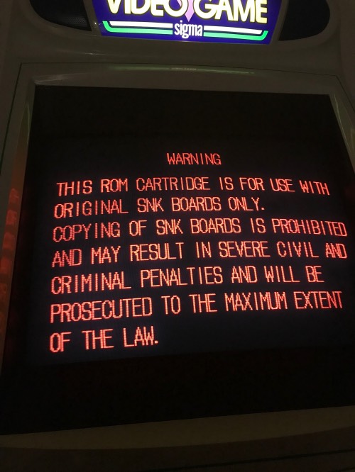

My set-up is: slot MVH 1FS jap bios, Sandisk SD (formated on a PC) with new menu, on Jaleco cab.
- Endless reboot on Alpha Mission II/ASO II
- impossible to play Pulstar: commands are down, I have to turn off the system. I tried on slot 1 and slot 2.

I had similar boot issues with my 1FS, you can try lowering your voltage as a temp fix (around 4.6-4.7 is what I was using).
if the voltage lowering fixes the problems then DS is aware of the issue and working on a fix.
but I can't as I am not using only the MultiMVS on this cab.
4.8v should be fine for all MVS carts, and again this is only a temp thing... It's being addressed.
I would recommend you dial down the voltage for now.
Don’t you check/adjust voltage when you change PCB’s?
Please check voltages under load when/if you swap PCBs/motherboards, some demand more power than others.
